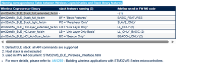

  2. That does not depend on the Transparent Mode example but on the Stack variant that you are using. the stm32wb5x_BLE_Stack_full_fw is dedicated for Basic Features (BF) that does not support the HCI_READ_LOCAL_SUPPORTED_FEATURES command. The stm32wb5x_BLE_Stack_full_extended_fw does support all the API commands.  Other Stacks also support those functions. refer to the Questions 3 for more details.
  3. To Know the Compatibility between stacks and commands, you may refer to the Tables 1, 126, 136, 169, 270, 365, 384, 393, 409, 419, 449 and 461 of the AN5270 Rev30. together with this table: STTwo32_0-1747040573170.png
  4. For the Stack, you can use the stm32wb5x_BLE_Stack_full_extended_fw.bin stack that does support all API commands. For the Zephyr examples, those examples are made by Zephyr so, you may can check with them for such a recommendation.
