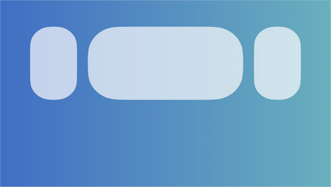

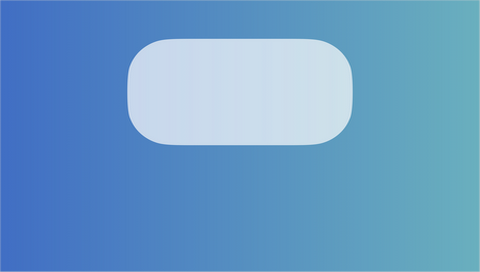

2021-05-27 1:49 AM
Thanks for the hint. I will check. I am sending two images that I want to replace.
On one background, I want to set the time with the buttons. I want to display the counting on the second background.
Can I program it to display in the same field after switching background?
Andrzej
2021-05-27 3:06 AM
You can use the same trick of turning the buttons or counter invisible when you switch backgrounds. What you have to be careful about is in which order you have put the widgets in: as long as you put the text "above" in the tree then your text will be displayed above the background (dont forget to use the invalidate() function)
/Romain
