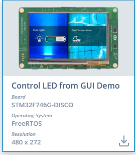

I also recommend checking out our board-specific demo, "Control LED from GUI Demo". It also shows how to turn an LED on and off from a TouchGFX application.
