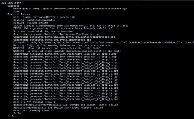

Hello!
I set the wildcard range to 0x0000-0xFFFF to use all characters contained in the "Pretendard JP" font.
However, I get an error when generating code with TouchGFX Designer.
Of course, specifying small wildcard ranges work, but I also want to support multiple languages with as few language packs as possible.
Is there another way to include all characters in one resource without specifying wildcards?
I also tried entering about 20k Unicodes into the Wildcard Characters field, but the error was the same.
== Error message ==
ERROR: Illegal sizeInKerningTable for glyph 0x002C (439 not in range [0..255])
ERROR: While generating font from assets/fonts/PretendardJP-Bold.otf
An error occurred during text conversion
Cleaning generated files from generated/texts and generated/fonts.
Generating generated/fonts/include/fonts/GeneratedFont.hpp
Generating generated/fonts/src/GeneratedFont.cpp
Generating generated/fonts/include/fonts/UnmappedDataFont.hpp
Generating generated/fonts/src/UnmappedDataFont.cpp
Generating generated/fonts/include/fonts/CachedFont.hpp
Generating generated/fonts/src/CachedFont.cpp
Generating generated/fonts/include/fonts/FontCache.hpp
Generating generated/fonts/src/FontCache.cpp
Generating generated/fonts/src/ApplicationFontProvider.cpp
Generating generated/fonts/include/fonts/ApplicationFontProvider.hpp
Generating generated/texts/include/texts/TextKeysAndLanguages.hpp
Generating generated/texts/include/texts/TypedTextDatabase.hpp
Generating generated/texts/src/TypedTextDatabase.cpp
Generating generated/texts/src/Texts.cpp
Generating generated/texts/src/LanguageGb.cpp
Command: "../Middlewares/ST/touchgfx/framework/tools/fontconvert/build/win/fontconvert.out" -f "assets/fonts/PretendardJP-Bold.otf" -i 13 -w 16 -r 16 -o "generated/fonts" -c "generated/fonts/UnicodeListPretendardJP_Bold_otf_16_4.txt" -n "PretendardJP_Bold_otf" -b 4 -v 0 -d 63 -e 0 -ct yes -bf no -ff 0 -ffu 0 -ba
Warning: Skipping font kerning information due to space constraint
WARNING - Char 0x1 is used but does not exist in the font!
WARNING - A total of 43561 Unicode characters did not exist in the font!
Generating generated/fonts/src/Font_PretendardJP_Bold_otf_16_4bpp_0.cpp
Generating generated/fonts/src/Font_PretendardJP_Bold_otf_16_4bpp_1.cpp
Generating generated/fonts/src/Font_PretendardJP_Bold_otf_16_4bpp_3.cpp
Generating generated/fonts/src/Font_PretendardJP_Bold_otf_16_4bpp_4.cpp
Generating generated/fonts/src/Font_PretendardJP_Bold_otf_16_4bpp_5.cpp
Generating generated/fonts/src/Font_PretendardJP_Bold_otf_16_4bpp_6.cpp
Generating generated/fonts/src/Font_PretendardJP_Bold_otf_16_4bpp_7.cpp
Generating generated/fonts/src/Font_PretendardJP_Bold_otf_16_4bpp_9.cpp
Generating generated/fonts/src/Font_PretendardJP_Bold_otf_16_4bpp_10.cpp
Generating generated/fonts/src/Font_PretendardJP_Bold_otf_16_4bpp_11.cpp
Generating generated/fonts/src/Font_PretendardJP_Bold_otf_16_4bpp_12.cpp
Generating generated/fonts/src/Font_PretendardJP_Bold_otf_16_4bpp_13.cpp
Generating generated/fonts/src/Font_PretendardJP_Bold_otf_16_4bpp_14.cpp
Generating generated/fonts/src/Font_PretendardJP_Bold_otf_16_4bpp_15.cpp
Generating generated/fonts/src/Font_PretendardJP_Bold_otf_16_4bpp_16.cpp
Generating generated/fonts/src/Font_PretendardJP_Bold_otf_16_4bpp_17.cpp
Generating generated/fonts/src/Font_PretendardJP_Bold_otf_16_4bpp_18.cpp
Generating generated/fonts/src/Font_PretendardJP_Bold_otf_16_4bpp_19.cpp
Generating generated/fonts/src/Font_PretendardJP_Bold_otf_16_4bpp_20.cpp
Generating generated/fonts/src/Font_PretendardJP_Bold_otf_16_4bpp_21.cpp
Generating generated/fonts/src/Font_PretendardJP_Bold_otf_16_4bpp_22.cpp
Generating generated/fonts/src/Font_PretendardJP_Bold_otf_16_4bpp_23.cpp
Generating generated/fonts/src/Font_PretendardJP_Bold_otf_16_4bpp_24.cpp
Generating generated/fonts/src/Font_PretendardJP_Bold_otf_16_4bpp_25.cpp
Generating generated/fonts/src/Font_PretendardJP_Bold_otf_16_4bpp_26.cpp
Generating generated/fonts/src/Font_PretendardJP_Bold_otf_16_4bpp_28.cpp
Generating generated/fonts/src/Font_PretendardJP_Bold_otf_16_4bpp_29.cpp
Generating generated/fonts/src/Font_PretendardJP_Bold_otf_16_4bpp_30.cpp
Generating generated/fonts/src/Font_PretendardJP_Bold_otf_16_4bpp_31.cpp
make[1]: *** [texts] Error 1
generated/simulator/gcc/Makefile:225: recipe for target 'texts' failed
make: *** [assets] Error 2
simulator/gcc/Makefile:32: recipe for target 'assets' failed
Failed

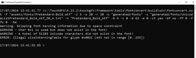

2024-07-17 7:33 AM - edited 2024-07-17 8:37 AM
Hi @potentializ
I downloaded the font
https://fontmeme.com/fonts/pretendard-font/
and got an error as well:
And fontconvert.out ran in CLI
The tool is here
c:\TouchGFX\4.23.2\touchgfx\framework\tools\fontconvert\build\win\fontconvert.out
@GaetanGodartThis error might be something fontconverter Dev team might want to look at. The font does not seem to be 'corrupt' as I was able to open it in FontForge application.

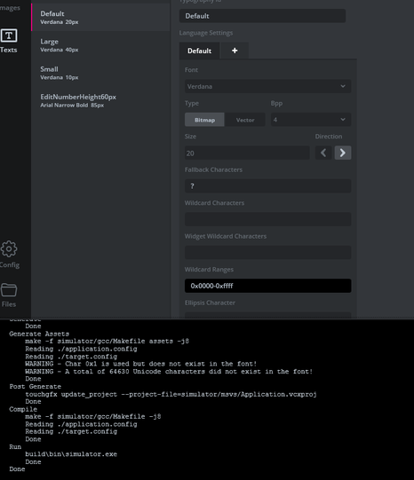

2024-07-16 9:46 AM
Hi @potentializ
My project runs Okay. Only get warning:
WARNING - A total of 64630 Unicode characters did not exist in the font!
Generating generated/fonts/src/Table_verdana_20_4bpp.cpp
It seems there is some error with a specific font internaly in you project, maybe structure broken ?
Maybe you could try to run Gfx font converter tool on its own from Windows CLI to learn more about the issue with specific font file. Or create a dummy project with single font causing a problem.

Looking at ferro's answer below, there is no problem specifying 0x0000-0xFFFF in verdana font(Regardless of whether Unicode Glyphs are supported or not).
