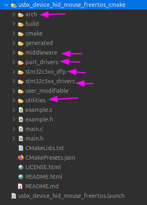

No, the GitHub does not have the full build with all source code. It only has the relevant example files. Please compare the files for any of the examples when the .zip is downloaded versus the files present in the GitHub.
More specifically. The Github contains the app code and generated directories, but lacks the following directories (as pointed to in the screenshot).
@Pavel A. wrote:Have you tried to build the example as is, without any changes? In which IDE?
