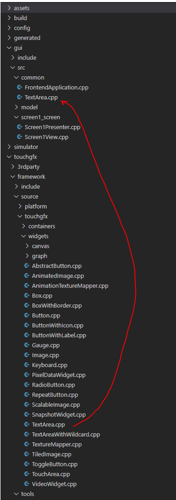

2023-04-25 2:10 AM - edited 2023-11-20 7:41 AM
Sorry for the huge delay.
Since we resolved that internally together, I'll answer and close this post so other people can find a fix if they meet a similar issue.
This issue was fixed in TouchGFX 4.21.0.
If you still want to use 4.20.0, you can still fix the bug manually :
Replace
while (wtis.getCurrChar() != 0 && widgetRectHeight > lineHeight);With
while (wtis.getCurrChar() != 0 && widgetRectHeight >= lineHeight);/Yoann
