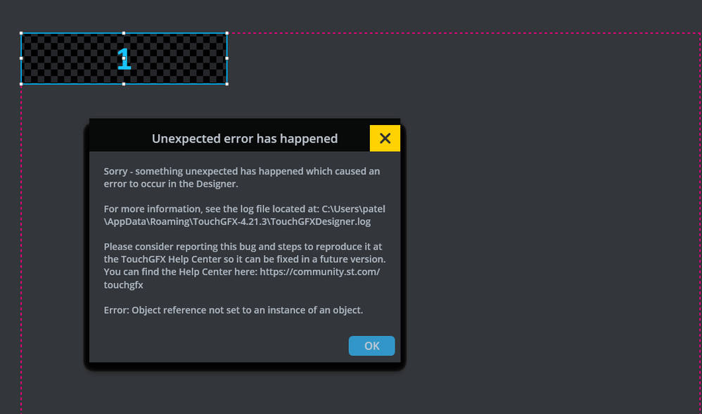

When containers are copied within the software the touchgfx 4.21.3 crashes.
Log Outputs:
2023-04-17 15:50:37,616 [1] ERROR TouchGFXDesigner.App: Object reference not set to an instance of an object.

2023-04-19 6:39 AM
Hello @Community member,
I'm not able to reproduce your issue, does it simply happen when you copy paste a custom container ?
/Yoann
2023-04-24 8:06 AM
Hello @Yoann KLEIN
Yes. To reproduce the issue copy a custom container and paste the custom container into the container section to make a copy. Once you make any changes in the copied container the software crashes with this error.
It is not project specific. I am able to reproduce this issue in a new project also.

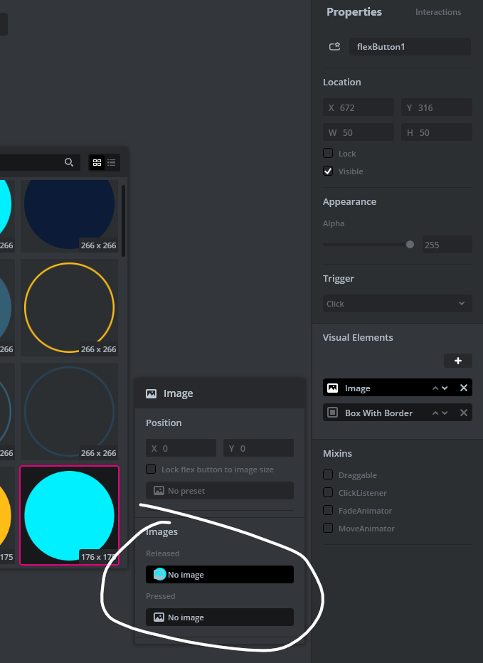

There is another bug in version 4.21.3. Sorry for not creating another thread.
Bug: Flex Button
When you add a Flex Button to the project and try adding an image in the visual elements, it doesn't register the selected image. I hope the screenshot helps to understand the issue.
2023-04-24 11:26 PM
I also had the joy with this FlexButton image bug! Fortunately I had the "correct" FlexButton on another screen and could copy it. This must be a "new" bug, as it worked in older versions.

2023-04-25 12:26 AM
We are already aware of those issues with the FlexButton. It's indeed something new, and we'll try to fix for TouchGFX v4.21.4.
Thanks for reporting though :)
