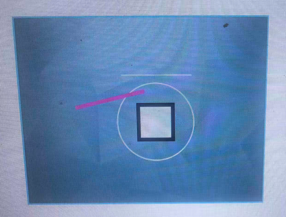

It should look like this:

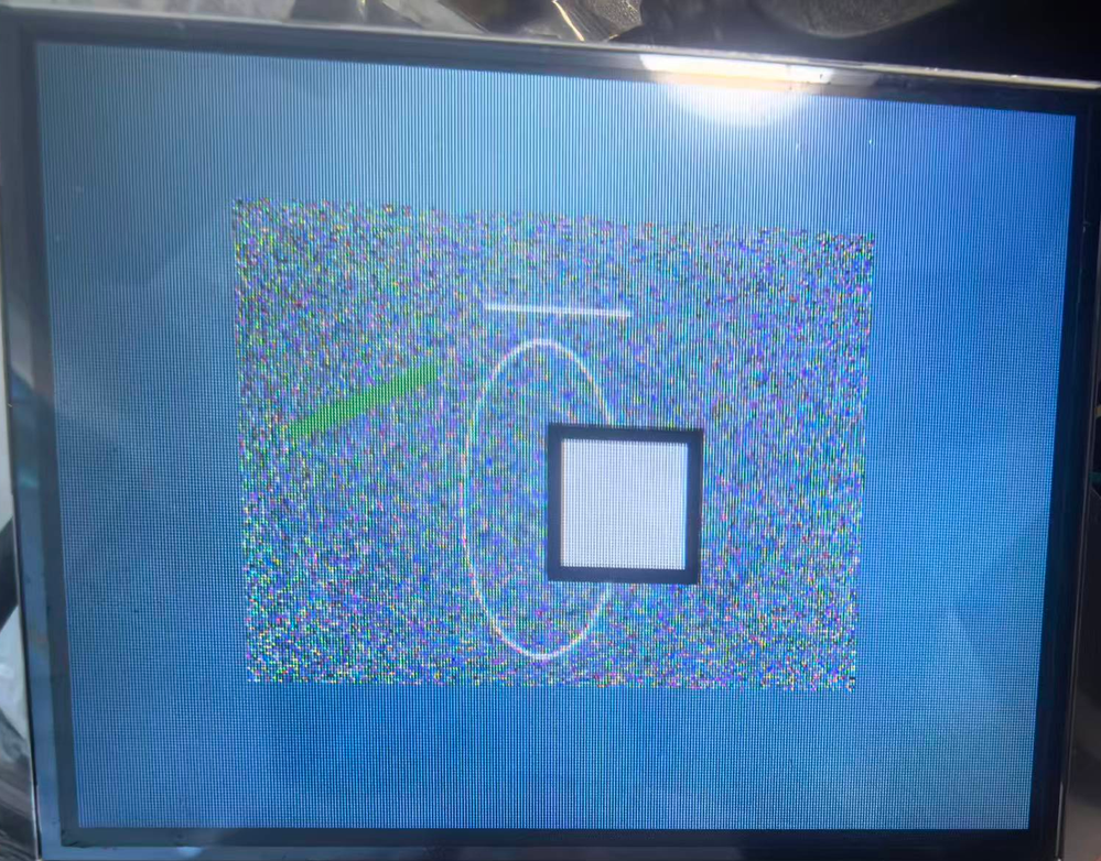

but instead it looks:
hdgFace is a cacheable Container size 200*150. these two lines,one circle and one box with border are drawn to hdgFace.the box with border looks normal,but the other object is only half size on X axis.

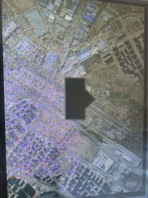

Hello @JohanAstrup
Thanks for your kind reply.
I tried your code,It works but only partly.
Half of the display is good,the other half have random pixels on screen.

Hello @JohanAstrup
I finally make these random pixels disappear,by using  memset()  before render.
But then I found another problem.

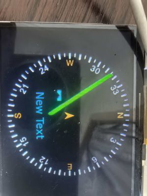

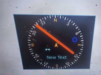

this is what I want:
but after download I got this:
if you put a image into the container(using dynamic bitmap ARGB),then it shows correctly,but if you draw a line or a circle,it shows wrongly, and the circle does not draw at all.
Line color changed.Line position and length changed.
