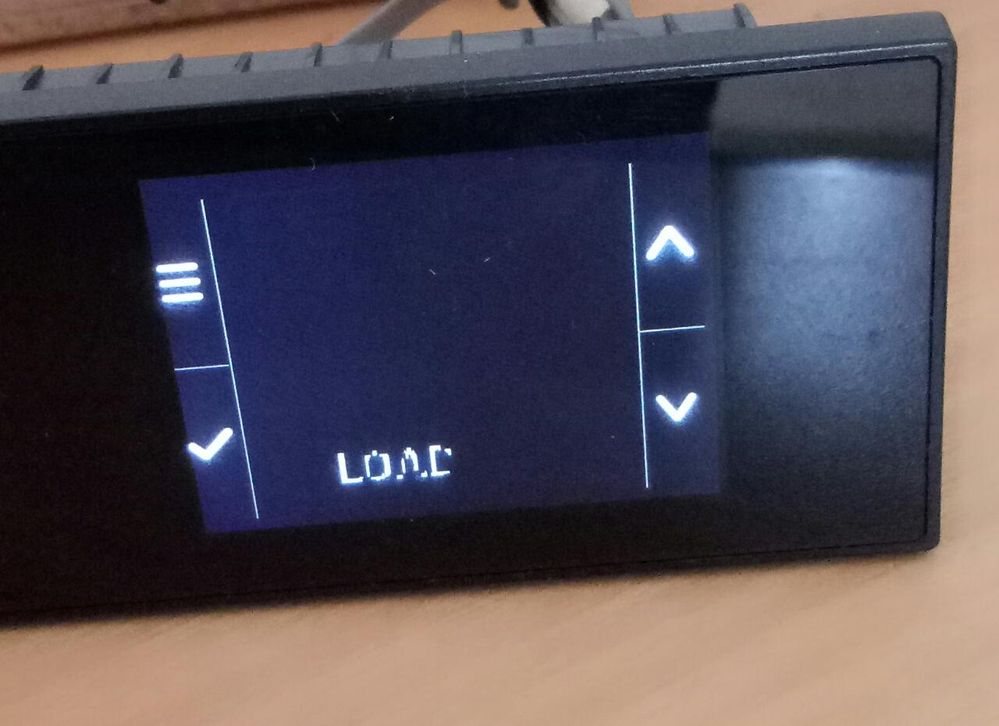

In touchgfx software....In Display Board......
Is there is any way so that I can fix it....?

2020-11-08 10:03 PM
Greetings,
My problem got solved by changing the MPU_Config() from main.cpp. Thanks for your Support.
Regards
Rishikesh G
