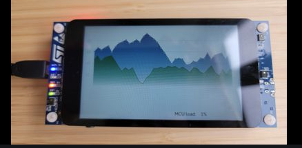

2025-10-13 11:46 AM
Here is another one that matches my previous project.
So something changed - the new project, I just created a new one and put one button w/text. Flipped 180.

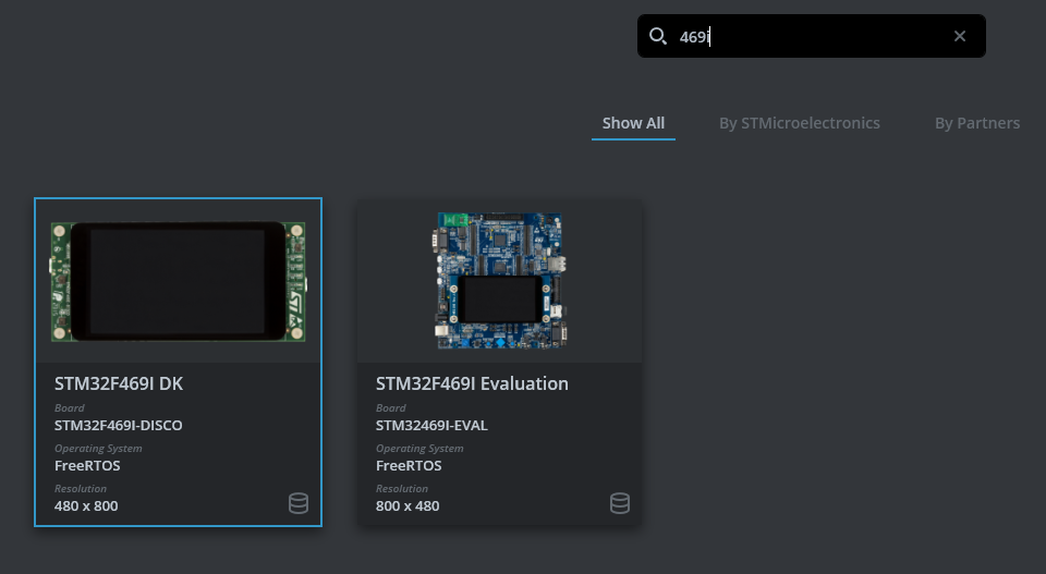

2025-10-15 6:32 AM - edited 2025-10-15 6:55 AM
It's literally the same board - why is it flipped 5 months later when I create a new project? If screen orientation isn't something that is easily set in TouchGFX, how can I trust my production hardware won't do the same thing if I do an update 5 months later?
2025-10-15 6:45 AM
If I go back to an older version, it won't work on this board. It is the -AU1 version and it looks like it is the latest rev.
One curious thing - the .IOC from my old project is called STM32F469I-DISCO-REV-AU1.IOC. When I create a new project now, the file is called STM32F469I-DISCO.IOC.
Was there a change in TouchGFX Designer or is this board missing from list when I create a new project?
