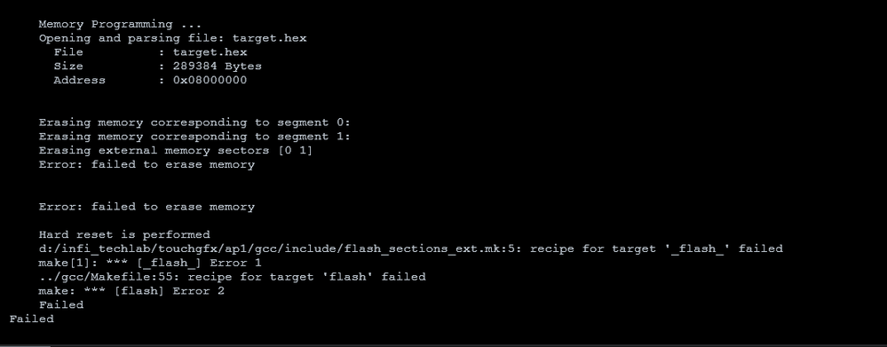

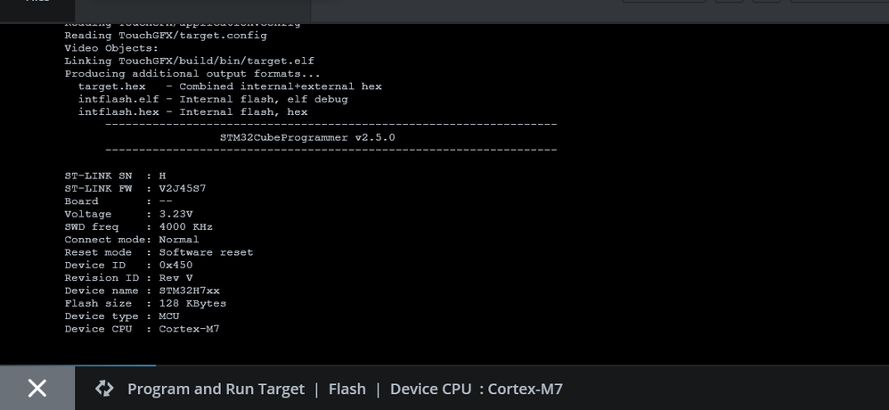

> I created the UI , when i directly try to program and run target it get stuck on programmer part and then fails

The TBS (TouchGFX Board Setup) you choose works for the STM32H750-Discovery board which has specific memory, pins, PCB, display, etc.
You seem to be using another board.
Therefore, you will have to create your own TBS, to do so, you can get inspired by our TBS and you can look at this guide .
