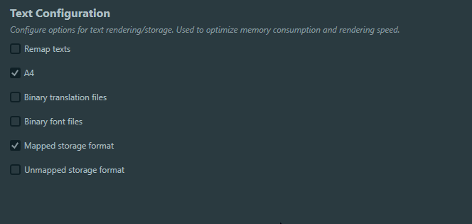

2021-11-24 9:38 AM
Uncheck Binary font files. I'm pretty sure that's the problem. I was able to reproduce the the failed assertion with your Text Configuration settings. The only change I needed to make to properly run it and have the text visible was unchecking Binary Font Files
I checked my Text Configuration and the options I have checked are Remap Texts, A4, and Mapped Storage Format. Perhaps use this default configuration unless you really need to use binary files.
See the support library for binary files: looks like they have to be linked in to your program, and also require an additional configuration step that you need to manually implement in your code.
2021-11-24 1:10 PM
This configuration has fixed my problem!
Thanks a lot @Michael K !
I still need to be able to use the font as binary files (client requirement).
I will investigate soon how the FrontEndAppication relates to the fonts initialization.
