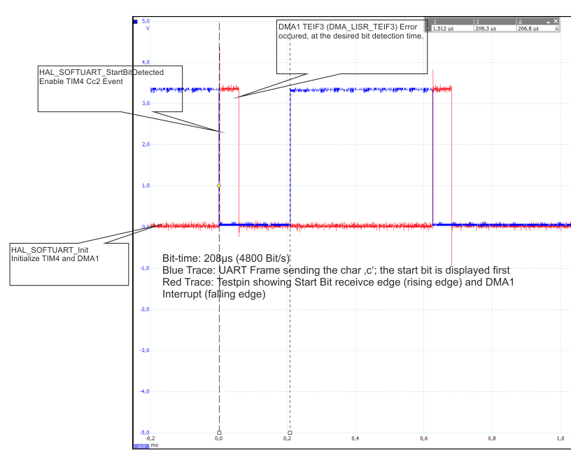

The start bit is detected correctly and initializes the TIM4 to generate the event. When first sampling event occurs a DMA Transfer error occurs, when using TIM1 instead everything works correctly. Anyhow MPU is not initialized.

TIM1/DMA2 and TIM4/DMA1 are initialized the same way, timing and registers; With TIM1/DMA2 everything works fine; using TIM4/DMA1 causes a DMA_ TEIF3 interrupt.

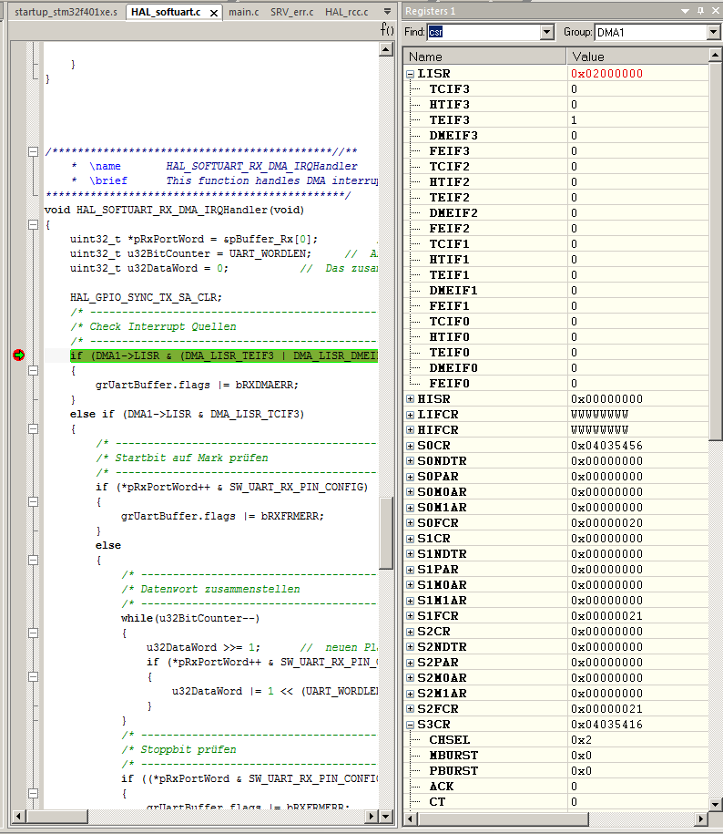

}The second Version produced TEIF3 interrupt from DMA1 in the DMA1 Stream 3 Interrupt. Is there any hint what could be the reason?
