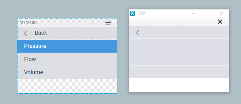

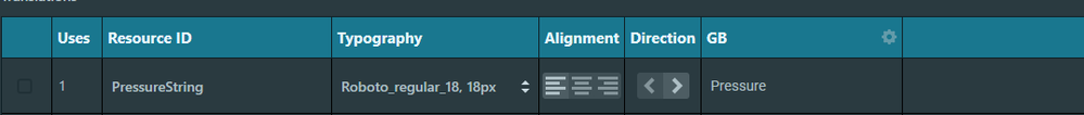

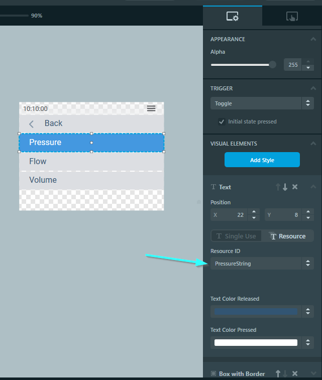

When running the simulation, the text resources are invisible.
Additional notes:

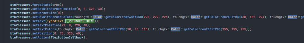

Q: Is the resource properly configured?
A: Yes. I think so. Here's an example of the PressureString:

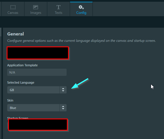

Q: Is the simulator Locale configured to GB?
A: Yes. I think so.Q: Do the fonts exist?

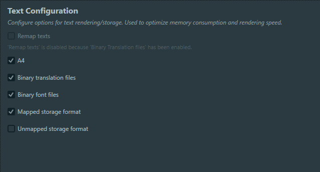

Uncheck Binary font files. I'm pretty sure that's the problem. I was able to reproduce the the failed assertion with your Text Configuration settings. The only change I needed to make to properly run it and have the text visible was unchecking Binary Font Files
I checked my Text Configuration and the options I have checked are Remap Texts, A4, and Mapped Storage Format. Perhaps use this default configuration unless you really need to use binary files.
See the support library for binary files: looks like they have to be linked in to your program, and also require an additional configuration step that you need to manually implement in your code.

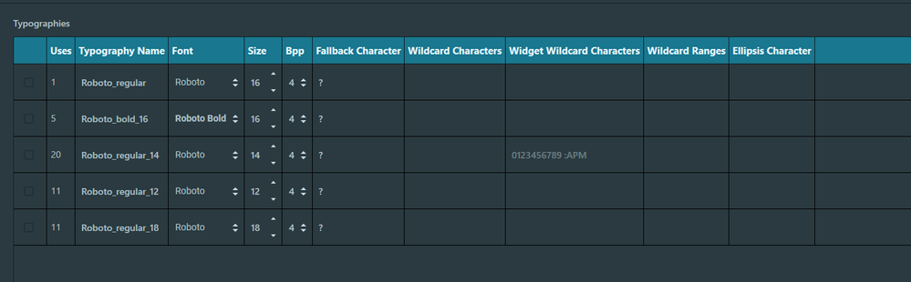

Maybe you could swap all the typographies to a built-in font? I see the clock is also missing, so maybe there's something weird going on with the font files.
2021-11-23 2:18 PM
Currently, all text areas are not displayed.

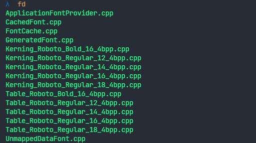

Here's the generated txt list inside \TouchGFX\generated\fonts\
It seems to be similar to my GUI config

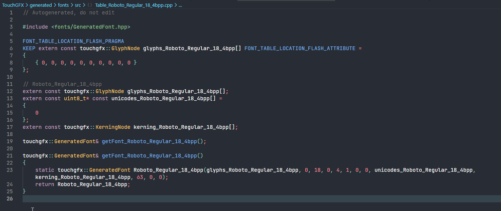

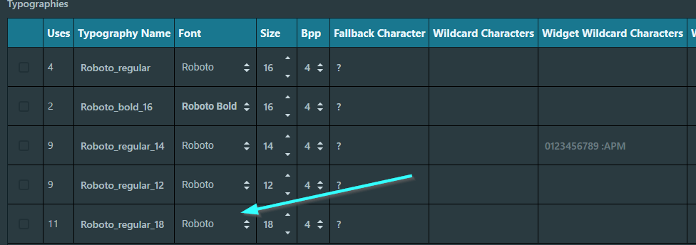

Check the Roboto Regular 18 cpp - that's the one used in your Pressure resource. If it's generated the glyphs you'll see a huge array of hexadecimal bytes, with comments separating them into the different letters. Just looking at the Roboto Regular 12 I'm not seeing the glyph for '?', which is the fallback character and should be generated for each typography regardless of usage (I think, not at my workstation right now).

This is the entire Table_Roboto_Regular_18_4bpp.cpp.
This doesn't look right to me.

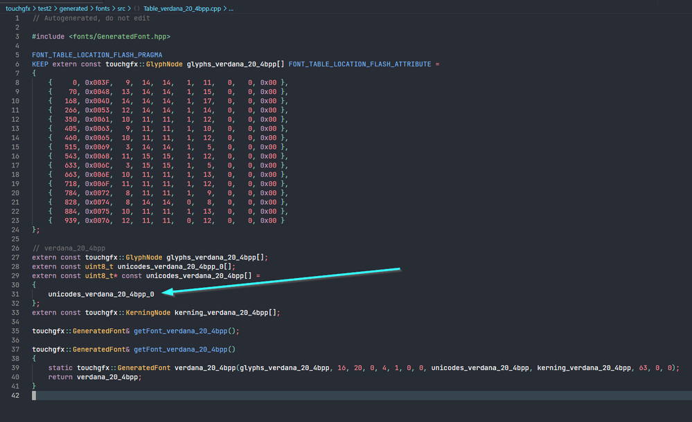

Here is a similar "table" file in a test project I just created.
As you can see the file is clearly different.
I tried to create a new typography with Arial instead, but without success (same problem as before).
I also checked if the TTF file existed
Maybe this has to do with the project's text configuration?

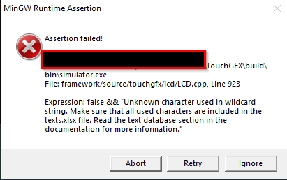

Not sure if that's helpful, but when playing with the Text configuration, I get the following error
What do you think?
