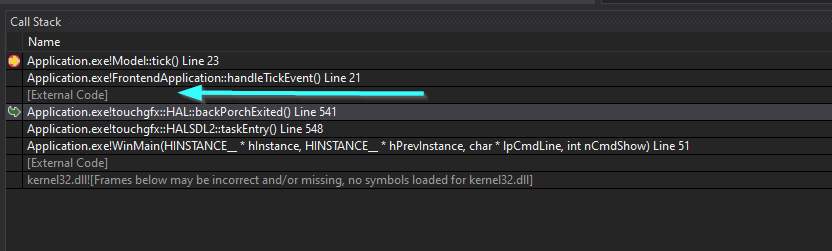

I'm using Visual Studio (TouchGFX/simulator/msvs/Application.sln) to debug my project's simulation.
I want to understand what is causing an exception.
The problem is that the exception is not in the codebase.
See the call stack here
How do I add those external files to the Visual Studio Solution?

EDIT:
After further investigation, It appears that the VS solution is not configured to see the Middlewares\ST\touchgfx directory. Could this be the problem?
2021-11-23 6:01 PM
I think FrontendApplication::handleTickEvent() is called by the TouchGFX engine, which comes as a prebuilt library and links into user code. VS may not be able to see the exact stack trace for functions inside the library.
2021-11-24 1:12 PM
Humm I think you're right Michael. this seems likely.
I'm not sure if somebody from ST would have a trick to debug the prebuilt library.
The more I see the code, the best I can debug.
