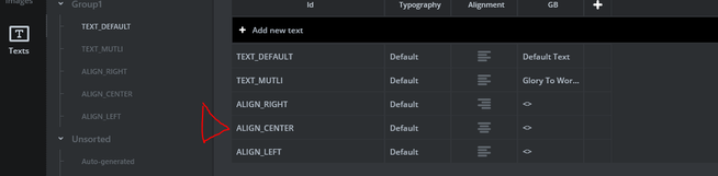

2024-11-27 7:54 AM
1. missing
#include <texts/TextKeysAndLanguages.hpp>
2. or ALIGN_CENTER is missing in Text view:
If not then past here compiler error screenshot please
2024-11-27 8:05 AM
Hi Ferro,
Number 2 was missing.
I added a new group, "ResourceID2" and made it center_aligned in the Designer. And then i my code wrote:
Line[i][j].setTypedText(touchgfx::TypedText(T_RESOURCEID2));Everything with this ResourceId2 is now centered.
