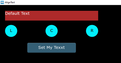

Hi @BhavyaSri
I use TextAreaWithOneWildcard
// T_ALIGN_LEFT, T_ALIGN_CENTER, T_ALIGN_RIGHT Ids text is "<>" with different alignment
// T_TEXT_MULTIALIGN holds the text to dispaly and alignment does not matter
TextAreaWithOneWildcard::setTypedText ( touchgfx::TypedText ( T_ALIGN_CENTER ) );
TextAreaWithOneWildcard::setWildcard ( touchgfx::TypedText ( T_TEXT_MULTIALIGN ).getText () );
TextAreaWithOneWildcard::invalidate ();
Example:

2024-07-08 6:42 AM - edited 2024-07-08 11:38 AM
Hi @BhavyaSri
Example:

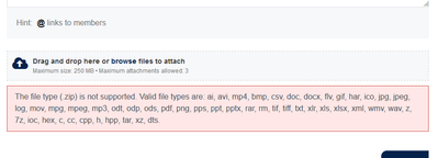

2024-07-08 7:56 AM - edited 2024-07-08 8:49 AM
Attached is Gfx project with extension .pdf - rename it to .zip. Forum does not allow me to attach file with .zip. Strange as I see .zip files shared here.
2024-07-08 7:58 AM
2024-07-08 8:04 AM

2024-07-08 8:37 AM
Hello @ferro ,
The ".zip" extension is not supported. Most people use the ".7z" extension to share their files.

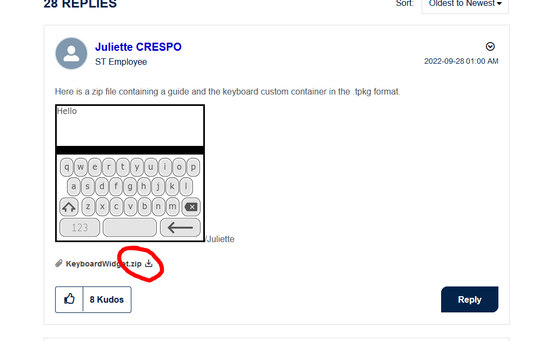

2024-07-08 8:42 AM
Thanks @GaetanGodart , I see. I saw shared .zip on 'share your widget' thread but that was 2022, it's changed since then.
