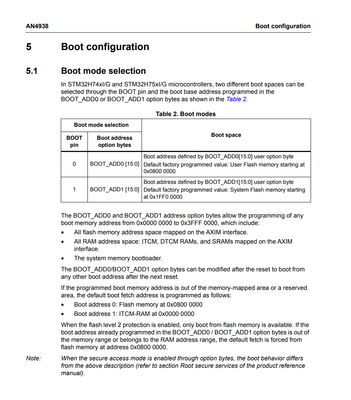

2026-04-21 4:44 AM - edited 2026-04-21 4:46 AM
No. The system bootloader is hardcoded at the memory area 0x1ff00000. Not possible to write at that memory region.
To run your own bootloader when Boot0 = 1, configure the BOOT_ADD1 option byte to point to your custom bootloader.
From AN4938:
2026-04-21 5:22 AM
ok how can i configure BOOT_ADD1 by setting the address where my custom bootloader should start when Boot0 = 1? maybe from the address 0x1ff09800 if it is possible to overwrite. only with STM32CubeProgrammer?
my idea is to put my bootloader outside the 1024K flash capacity so from 0x08000000 to 0x080ffff of the CM7 but still have it start my bootloader when Boot0 = 1 outside the max address of the flash.
2026-04-21 6:02 AM - edited 2026-04-21 6:03 AM
So put your custom bootloader at BANK2. You need to program that in the option bytes.
Please refer to the section: 2.6 Boot configuration in RM0399
2026-04-21 6:23 AM
Ok, so the only solution is to use bank 2 of the user main memory. Thanks.
