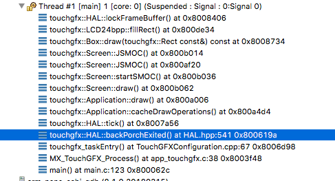

In debug mode I found that app stuck in lockFrameBuffer function.

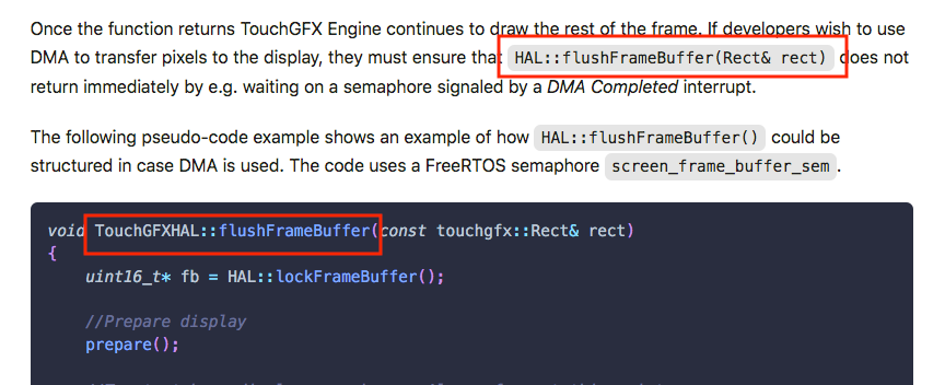

also can't understand next in documentation: HAL vs TouchGFXHal

If you checked my original message or video you see that I didn't not init LCD at all. So in code no work with LCD (init, send data or TE receive). Also I show dabug pause stacktrace. It stops not in hardfault but on lock framebuffer

::initialize called from main.c, after that go inside waitForVSync, timer at this moment generate tick, and app stuck on this
