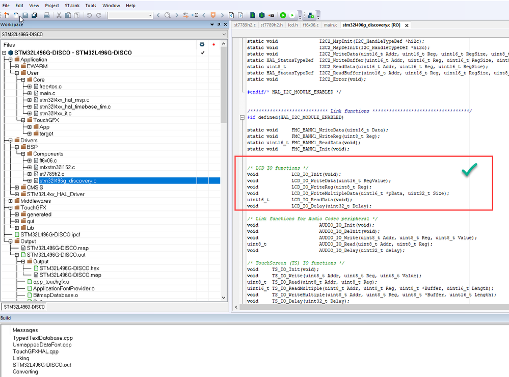

Found the BSP support file inside the en.stm32cubel4_v1-15-0 download.
Specifically,
Downloads\en.stm32cubel4_v1-15-0\STM32Cube_FW_L4_V1.15.0\Drivers\BSP\STM32L496G-Discovery\stm32l496g_discovery.c
Added the above to my BSP tree structure inside the IAR project. Compiles now without errors.

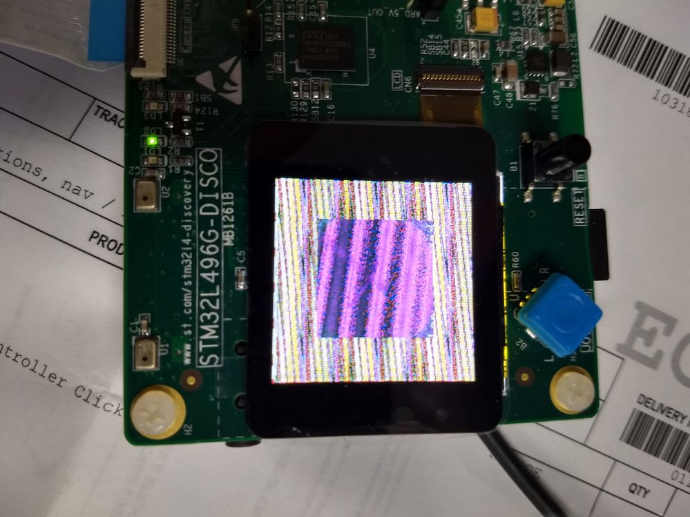

Created an output .hex file -> used the STM32CubeProgrammer to load this .hex file onto the target kit. The results are not matching the imported analog watch gui.

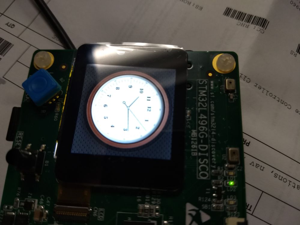

Using TouchGFX with this same kit -> Fresh project -> import the analog watch GUI example (nothing else) -> run Target -> the kit proceeds to display the watch properly.
Anything special required inside the IAR compiler to support this demo? Do see that the gcc compiler is referencing INTERNAL and EXTERNAL flash memory for this project which end up being flashed onto the target.

Is the single .hex file generated on the IAR tool the equivalent of the internal & external flash memory regions? The issue may be that the .hex file is not inclusive of all the memory regions that are required for this project.
Bad watch after programming of .hex file generated with IAR:
Good watch after Run on Target option was selected inside TouchGFX:

The generated .hex file contains 2 kind of data, a part that will be put in internal FLASH and another part that will be put in external one (see scatter file .icf file).
The data put in external FLASH is notably the input bitmaps such as the demo background and the clock background in your case.
To put data in external flash you need to provide an external loader in CubeProgrammer, in the "EL" section on the left panel search for the L496-Disco external loader and select it.
Then program you board again.
STM32CubeIDE contains its own internal CubeProgrammer and thus automatically program the external FLASH as well as the TouchGFX Designer that uses makefile-based build/flash toolchain, see "gcc\Makefile". In fact TouchGFX Designer builds 2 binary files intflash.bin and extflash.bin and program the external flash using your installed CubeProgrammer in command-line and uses the external loader for L496-Disco, see following line in the Makefile:
stm32cubeLoader := STMicroelectronics\\STM32Cube\\STM32CubeProgrammer\\bin\\ExternalLoader\\MX25R6435F_STM32L496G-DISCO.stldr
So again, just select the proper external loader (MX25R6435F_STM32L496G-DISCO) in CubeProgrammer and flash again, it will program both internal and external FLASH and you will then see the proper images instead of noise (uninitialized memory).

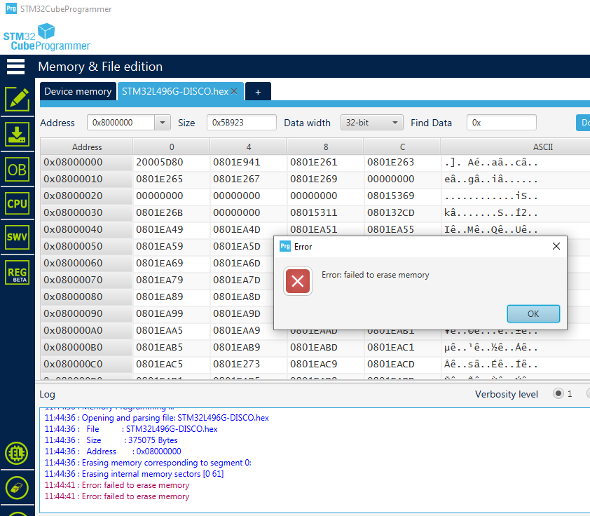

2) The STM32CubeProgrammer is acting a bit funky. Always appears to complain about an erase failure 2 times. Pressed Download again and the kit was reflashed ok.

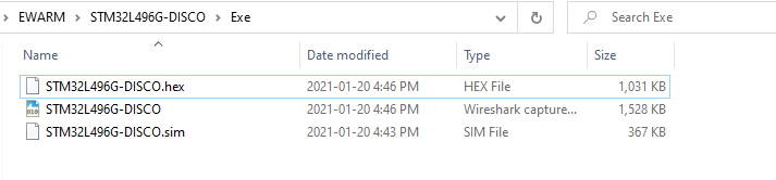

Nicolas, designing the GUI on TouchGFX (step # 1) ...launch STM32CubeMX -> selecting IAR (add any missing BSP files) -> re-generate for IAR with Generate Code inside TouchGFX -> now will compile fine under IAR. Reflash the target kit using STM32CubeProgrammer (load the .hex file from the exe folder in IAR) with the EL flag checked to reflash the INTERNAL and EXTERNAL flash memory devices.
