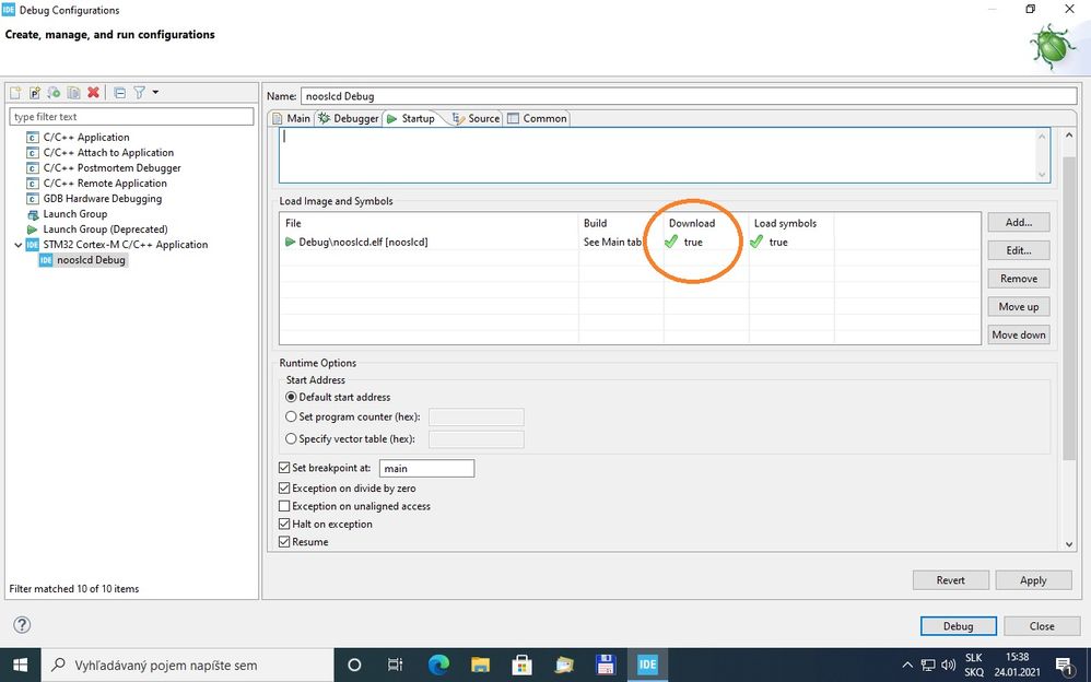

2021-01-24 6:46 AM
Here in CubeIde exist more type of projects, but when you use normal , then in Debug configuration window you have one settings for external loading and second for startup download. I mean simple is turn off Download and in command part write cmd line to flash only hex file .
or try disable only external loading on Debugger settings

2021-01-24 7:52 AM
No i mark download you need turn it OFF and scroll down to command part and enter comand here to flash hex only

2021-01-24 11:38 AM

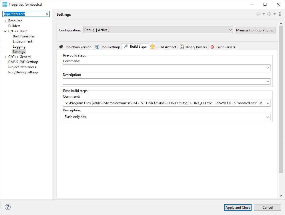

Simply click on marked True download then edit and off download checkbox , maybe symbols too. This start your debug without flash.
Then you need flash other way, one example
