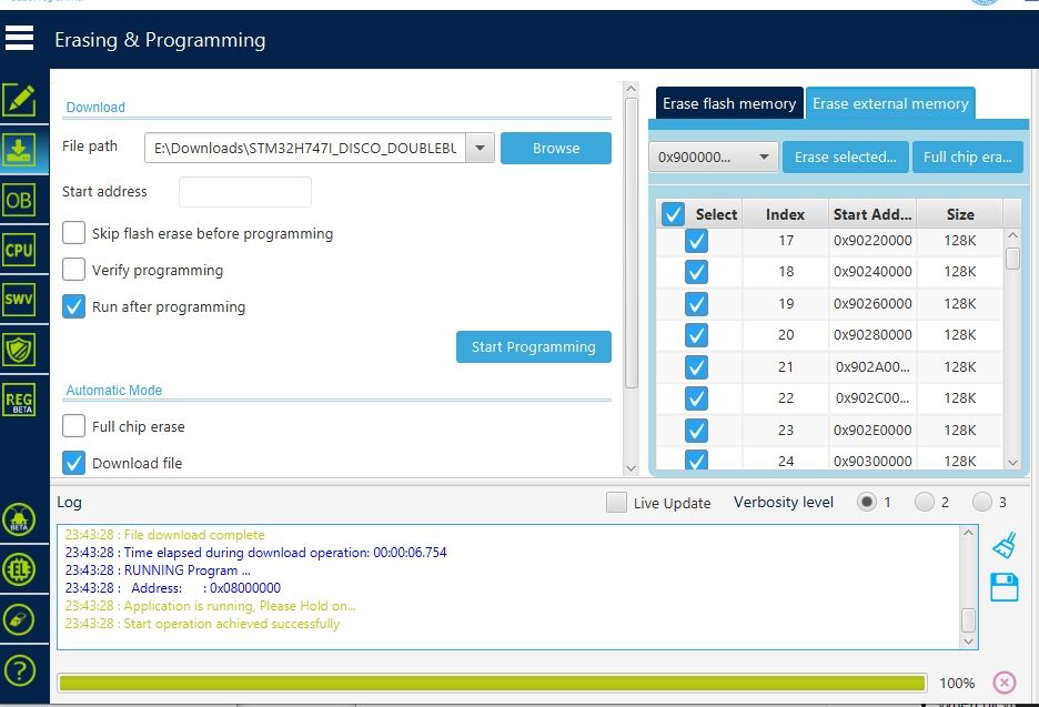

I tried programming @Community member file that he posted and on the first try i was able to get it working.
i programmed it with a simple TouchGFX project to overwrite what was in memory. Then I tried subsequent times to program the hex file and all i could get to show was the Blue bar with white space, so without the image of the girl flying the kite and the white text..
I then followed the link to this post ttps://community.st.com/s/question/0D53W00002ASl3lSAD/stm32h747-discovery-blank
and tried to program the demo but nothing was showing, just a black screen.

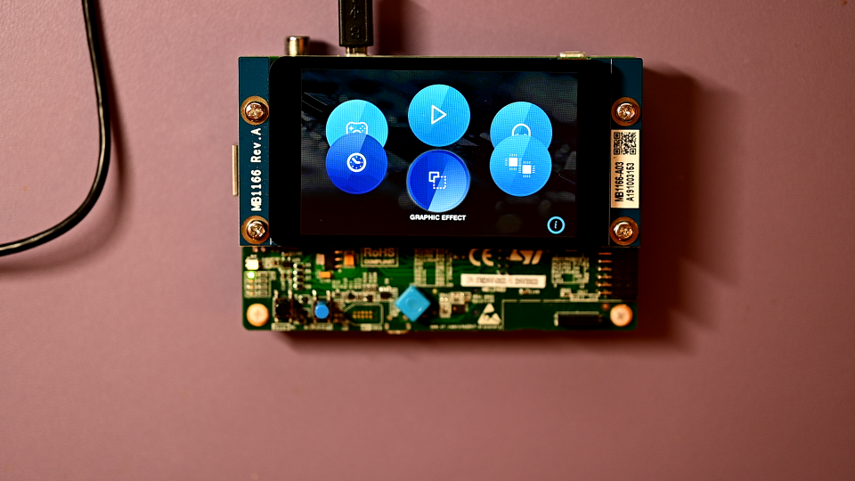

Then I checked all boxes for the Erase External Memory before i started programming. It took a long time to erase the external memory but it ended up programming and I got the demo to work.
So i tried both Tesla's file and the demo hex file going back and forth. They both are consistently programming and displaying correctly.

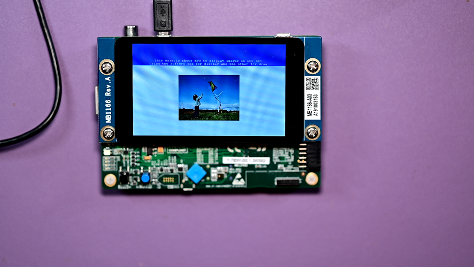

There is a pic of Karls board above running an example, it is an A03
