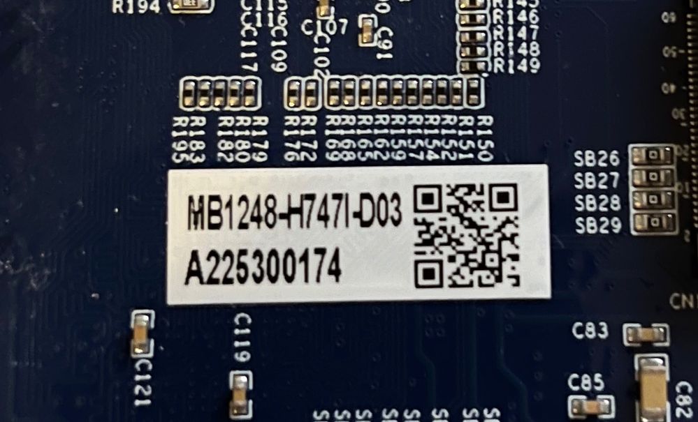

Could you please check the board revision (Under LCD)
2023-03-10 9:30 AM
D03 here
2023-03-10 9:31 AM
I tried the BSP example again after reattaching the display to see if it had magically been fixed but still same problem.

2023-03-10 9:38 AM
DO3 here.
Board was from Mouser, there is also another guy having issues which may be related, also from mouser: https://community.st.com/s/question/0D53W00002ASl3lSAD/stm32h747-discovery-blank

2023-03-10 11:53 AM
Yes, I have the same board. The only difference that I see is in the sticker with the QR code. In mine is A225301364
