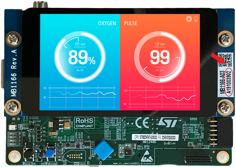

Yes. A03 or 01,02 doesn't matter, they're both A03.
The default screen serial num is A225300780 with a QR code on right.
The new screen is A214500023 without QR code.

Hello @BTurc.2
could you please give me the S/N (serial number) for your LCD , you can find how identify your SN on the picture below ,Thank you
