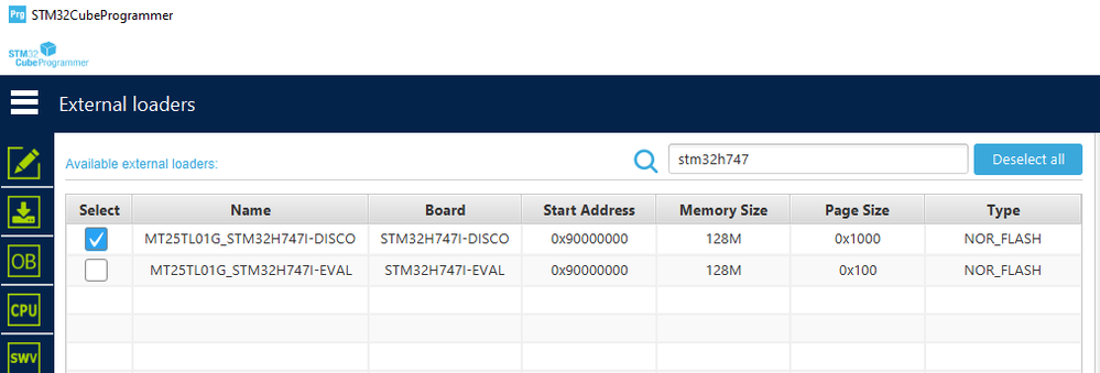

2023-03-10 6:00 PM
I don't see any mention of selecting an external loader?
2023-03-10 6:37 PM
If you're using Cube Programmer to program the bin, then try selecting a memory device
2023-03-10 10:19 PM
Just tried this file, exactly the same issue here.
2023-03-10 10:20 PM
Thanks. I have been using the correct External Loaded, it doesn't make a difference.
