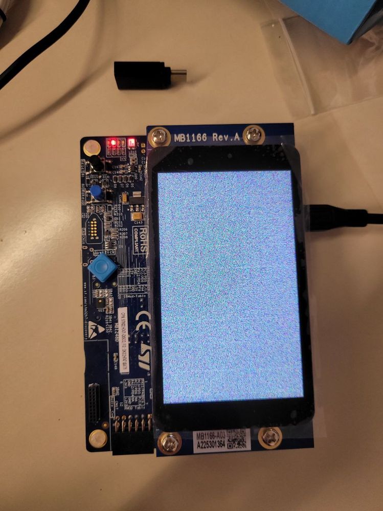

When I flash some .bin the LCD doesen't work. It just display the a noise picture. With similar examples does work and with more advanced examples like the EmbeddedWizard it works too.
When does not work, every time display the same static image:

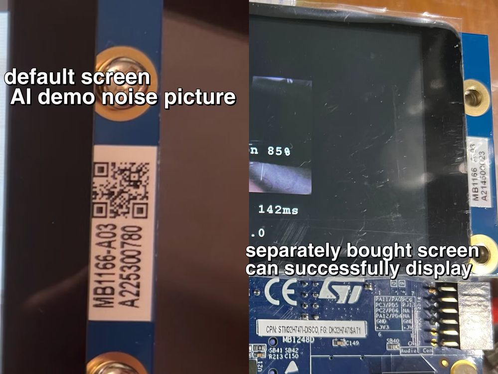

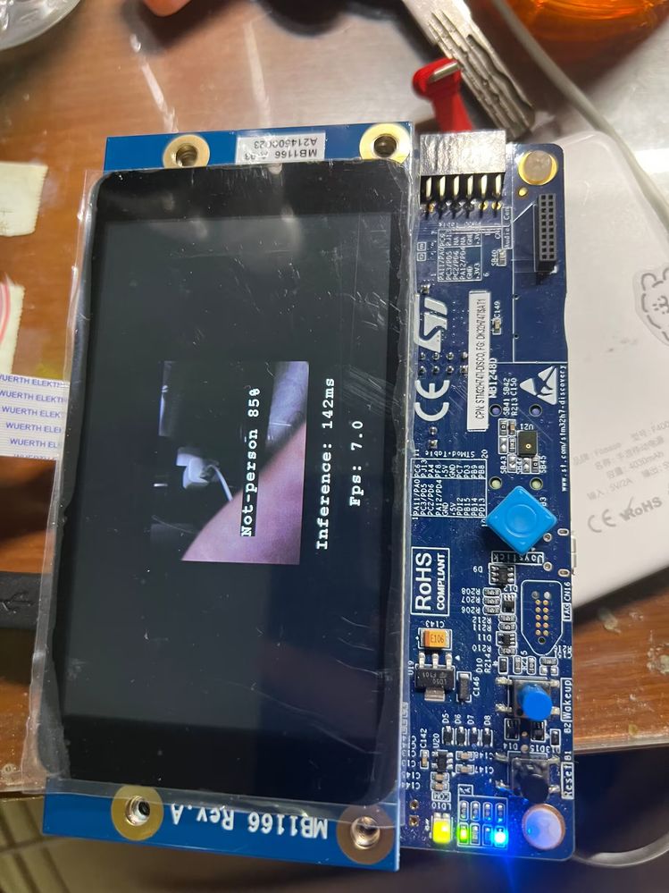

Hey Guys, GOOD NEWS!
It's the screen hardware problem, I bought a separate screen (B-LCD40-DSI1 4" WVGA TFT LCD) from mouser, which is same type but can normally display.
↓ difference between default screen and separate screen↓ package of screen module
↓ FP-AI-VISION demo:person detect

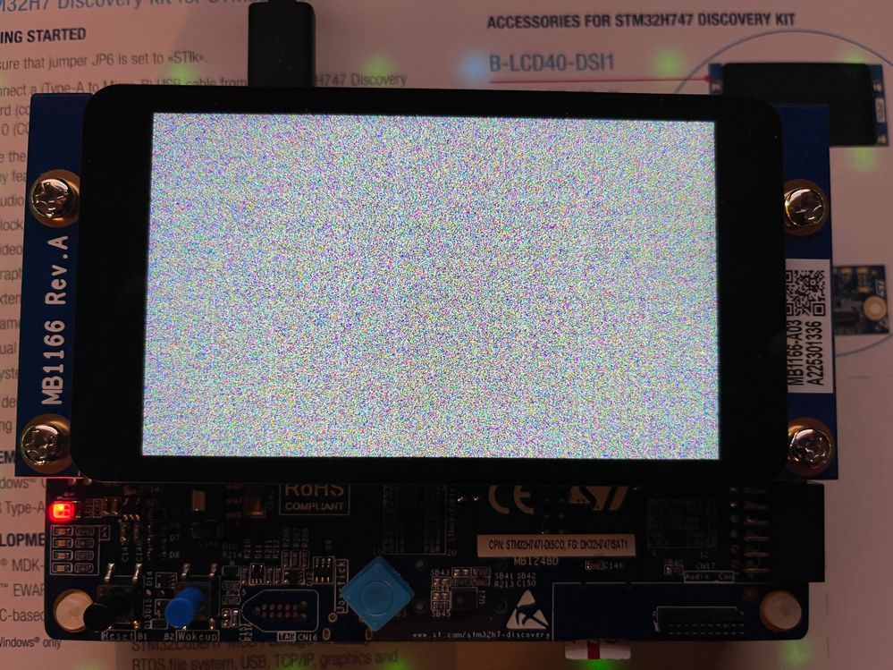

2023-03-10 8:22 AM
Hi Sarra, I think myself and BTUrc.2 have the same version looking at his image.
I have attached a higher res image where you can see the stickers.
