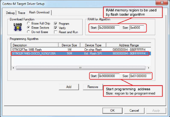

2019-05-30 3:30 AM
I find out.
But why it does not add the algorithm at flash memory?
Is it no need to add in?
2019-05-30 3:50 AM
What do you mean by "But why ..."
2019-05-30 5:27 PM
I mean that if you want to use QSPI external memory,shouldn`t it need to ad the corresponding algorithm?
Or how can it get the function with,and execute the data from it.
2019-05-30 11:45 PM
You mean for the initial programming of the firmware into the flash? This 'external loader' has to be supplied by you (as the pin mapping, transfer modes and flash initialization you want to use might not be the same as for the loaders shipped by ST). For this search for 'external loader' here, there are already a number of postings here for this topic.
