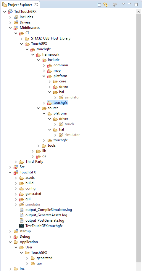

Below my project structure :

I don't have Atollic installed, but it's probably the same as CubeIDE since they're both eclipse based. Go to your top level project folder and choose properties. Then choose "C/C++ General" and you should have tabs to input library and library paths - input "Middlewares/ST/TouchGFX/touchgfx/lib/core/cortex_m7/gcc" as the librath path and "touchgfx-float-abi-hard" as the library
2019-05-28 4:00 AM
It seems you already have the gui and generated folders in your project. Are you sure it's a C++ project? Otherwise you'd get linker errors since no cpp files are considered for compilation.
Also seems there are a lot of issues for other folders, probably due to missing include paths.

Thank you !
the project build by following the best answer of the topic below + Adding touch GFX library as you explained.
Now I have a project built in Atollic with a fixed screen.
