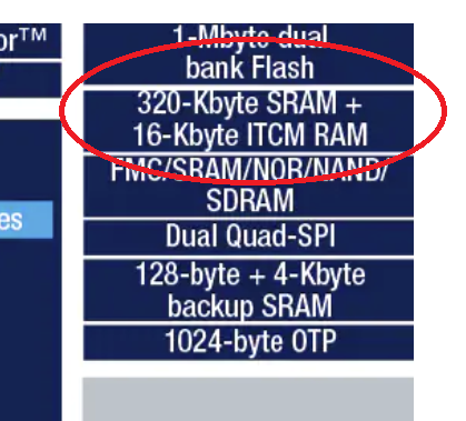

From their circuit diagram:

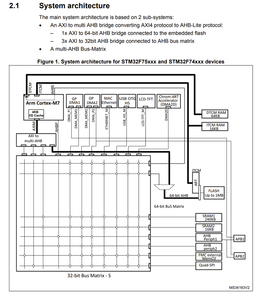

From Section 2 of their Reference Manual:
If I use the information from the circuit diagram, then it is sufficient. If I use Section 2, then I do not have enough. Because of this, I have two questions:
1) Can I actually use 320 kBytes for the display or 240 kBytes?
2) If 240kBytes, is there a way to reduce the display requirement to get it from 261kBytes to 240 kBytes?

I also made a sample project and, in the Build Analyzer, its Memory Regions state:
RAM
Start Address: 0x20000000
End Address: 0x2004FFFF
So does that mean I'd have access to 320 KB in contiguous memory?
2023-03-23 11:20 AM
SRAM1 240KB is the only one I think you have clean bus/DMA access too

2023-03-23 12:31 PM
Your LTDC config can combine L8 graphics. Then required RAM is 480x272 + 256x3
for single full screen framebuffer. Second choice is 256kB / 480 / 2 = 273
Place FB into SRAM1+SRAM2
Normal data place into DTCRAM
