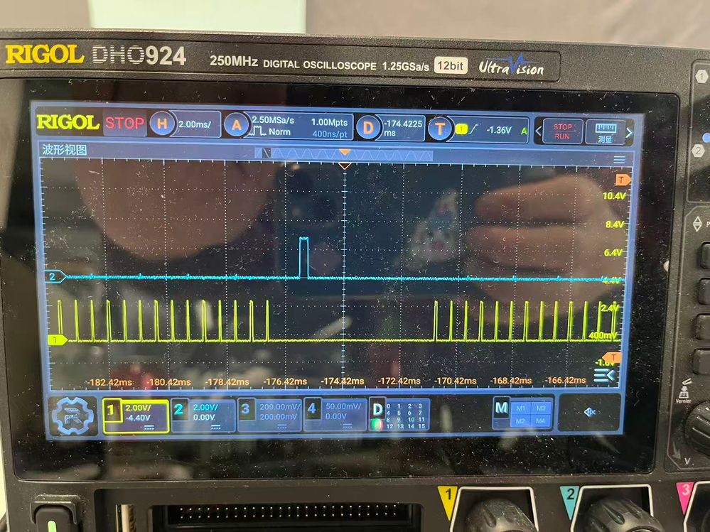

I've found the reason. Based on the output image size and PCLK clock, I can calculate the time required to output valid data, thus deducing that the high level period of HSYNC in the above image is the valid data output phase of the OV5640. The OV5640 manual description is unclear.

When I set the OV5640 register 0x4740 to 0x20 (default value), the output VSYNC (blue) and HSYNC (yellow) signals behave as follows: From the captured waveform, it is evident that VSYNC is high when data is invalid and low when data is valid; similarly, HSYNC is also high when data is invalid and low when data is valid. This matches the description of register 0x4740 in the OV5640 datasheet.
On the other hand, in the STM32 DCMI configuration, HSPOL and VSPOL indicate the signal level on the DCMI_HSYNC and DCMI_VSYNC pins respectively when parallel data is invalid. Based on the oscilloscope results, I should configure HSPOL = 1 and VSPOL = 1 to match the observed behavior. However, with this configuration the camera data cannot be captured correctly. In practice, I need to set HSPOL = 0 and VSPOL = 1 in order to successfully receive valid data from the OV5640.
2026-01-11 5:15 PM
