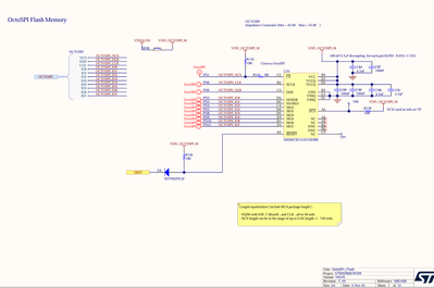

I recommend you to refer to the STM32N6570-DK schematic may help you to develop your custom board.
Thank you.

Hi Kaouthar, thanks for your reply.
But the problem is not about the schematics or PCB design; the problem is that I need to develop my application, and I need to have the datasheet for that.
I mean, to work with this IC, I need the datasheet. Currently, I am working on the dicover kit, and for this product states that
"The STM32N6570-DK Discovery kit is a complete demonstration and development platform for the Arm® Cortex®‑M55 core‑based STM32N657X0H3Q microcontroller."
But I am unable to develop Octo Flash-based applications as there is no datasheet for that. Why would ST offer a kit in which one of IC's datasheet is confidential while the kit is publicly available?
