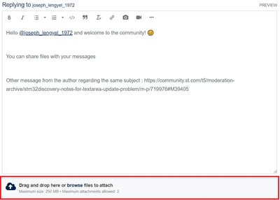

Hello @joseph_lengyel_1972 and welcome to the community! :smiling_face_with_smiling_eyes:
You can share files with your messages by clicking on "Drag and drop here or browse files to attach" bellow your message :
Also, I invite you to use the button </> to share code :
(I did it for you this time).
