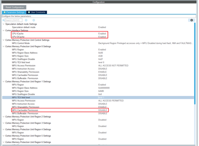

2025-09-25 7:15 AM
Thank you so much for giving me the idea that this is caused by cache...
I checked the code, checked the timing, checked the cable connection on the board, checked everything without realizing this was a cache-related issue. After setting MPU and disabling cache, the problem was solved.
2025-09-25 7:19 AM - edited 2025-09-25 7:21 AM
Don't disable the cache (that decreases the perf of your application) but use MPU to disable the cache from that specific region instead, i.e. setting that region as Device or Strongly-ordred (as provided above) .
2025-09-25 8:00 PM
I changed MPU config based on your sample code. Now data transferred to FPGA can be received correctly. Thank you for the help.

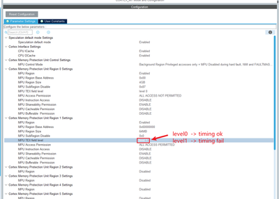

There is only one setting I found
In your code sample "MPU_InitStruct.Number = MPU_REGION_NUMBER1;"
Timing issue still remains under this setting. I changed this setting to level0 and the timing issue was solved.
level0(no timing issue)
level1(still timing is strange)
2025-09-25 8:02 PM
Sorry, my reply mislead you. I only disabled MPU cacheable permission. Not CPU cache.
