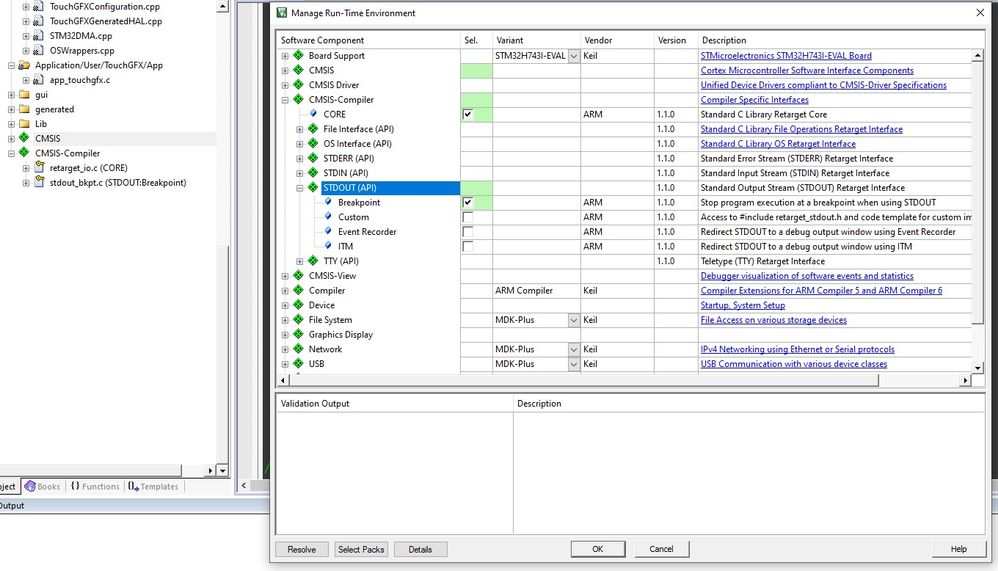

hi
problem solve by adding "returget.c" file
for more information refer to this link
https://developer.arm.com/documentation/ka002219/1-0/?lang=en
first test all 4 file in 3614.zip. one of them must solve problem
This is my final setup

2024-09-30 8:04 AM
hi
