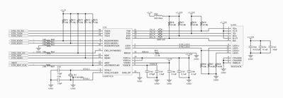

2025-09-19 12:05 PM
Another interesting clue. I put an oscilloscope on the REFCLK output of the LAN8742A. Normally this outputs a clean 50MHz clock to the STM32. After the ESD shock, the REFCLK signal goes away and just stays high, and does not recover.
I'm not seeing any bits in any registers on the LAN8742A that would control this, but I do see where this clock output would be disabled if the PHY is in a "general powerdown" state, so I'll check for that.
Here is the relevant section of the schematic, showing the LAN8742A circuit.
2025-09-19 12:59 PM
So is the refclk from the PHY used as the clock (HSE) to the STM32?
2025-09-19 2:37 PM
The 50MHz clock (ETH_REF_CLK) is supplied from the LAN8742A to PA1 on the STM32F429 for the ETH_RMII_REF_CLK signal.
The STM32's HSE is a 25MHz crystal, with a 32.768kHz crystal for LSE.
When the ethernet comm loss occurs, the rest of the controller keeps running - IO still works, the touchscreen display still works. But ethernet stops working(presumably because it no longer has the 50MHz REF_CLK to sync with).
I've done some additional testing of reading all the LAN8742A's registers to see what changes between working and not working. When it is working, SMR is 0x60E0, indicating all modes + autoneg available. After the event, SMR is 0x6000, indicating 10/half, autoneg disabled. This is configured using the strap resistors on the PHY; it is not set separately in software. I did add code to *force* these to all modes if it detects this has been changed, but I still don't have my 50MHz refclk out.
The only other thing I can see that would kill the 50Mhz REF_CLK is if the LAN8742A was told to power down, but it is not. I also added code to check this and make sure it is *not* in a powerdown mode.
I'm having a hard time scoping the 25MHz crystal on the PHY, as attaching the scope seems to throw it off quite a bit.
