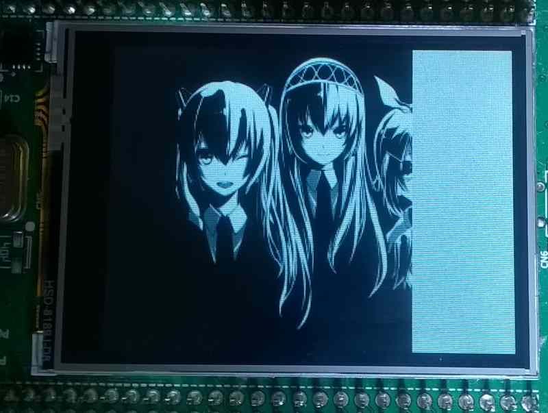

Good morning,
i have a problem with display orientation, i have changed the ili9341 register and the image rotate correctly but, i have a white portion of the display of 80 column in the side of the display.the LTDC registers are /* Configure horizontal synchronization width */ LTDC_InitStruct.LTDC_HorizontalSync = 9; /* Configure vertical synchronization height */ LTDC_InitStruct.LTDC_VerticalSync = 1; /* Configure accumulated horizontal back porch */ LTDC_InitStruct.LTDC_AccumulatedHBP = 29; /* Configure accumulated vertical back porch */ LTDC_InitStruct.LTDC_AccumulatedVBP = 3; /* Configure accumulated active width */ LTDC_InitStruct.LTDC_AccumulatedActiveW = 349; /* Configure accumulated active height */ LTDC_InitStruct.LTDC_AccumulatedActiveH = 243; /* Configure total width */ LTDC_InitStruct.LTDC_TotalWidth = 359; /* Configure total height */ LTDC_InitStruct.LTDC_TotalHeigh = 247;any solution?Thank you. #stm32 #lcd #discovery #tft #tft-ltdc-display-landscape2013-11-22 2:25 AM

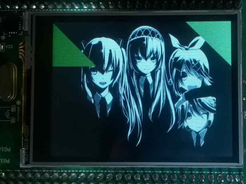

And the result is:#define
LCD_VAREA
0xF0
+80
// 240+80 = 320
I got:2015-04-10 3:42 PM
