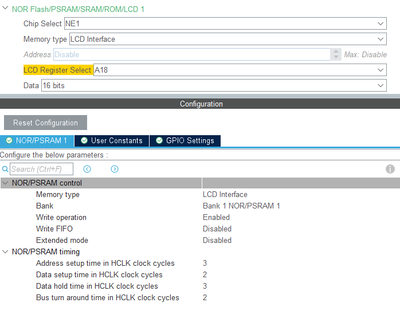

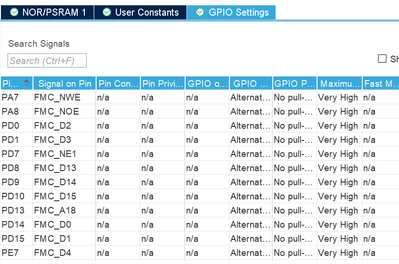

I am trying to configure an 8080 16-bit parallel LCD using FMC on an STM32H5563 development board, but it is inconsistent and unstable. I am getting a logic analyzer and will be able to provide screenshots of the signals in a bit.

Hardware used:
Configuration:

I want to establish and figure out the 16 bit parallel display communication for this smaller display to output data faster, I plan on eventually using a larger screen and doing more complex screen writes, SPI wouldn't be fast enough for that.
I have reduced speeds and it still functions normally, tested from various ranges between 2 and 30 MHz.
Adding the reset doesn't do anything.
I'm beginning to think more and more that it is the wiring through the breadboard since it does send some data/commands correctly but becomes unreliable.
