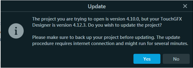

2019-10-18 1:59 PM
Ok, so maybe I am missing something here. I installed CubeIDE v1.1.0, CubeMx v 5.4. Setup TouchGFX within CubeMx and setup the location in CubeMX to be pointing to TouchGFX V4.12.3. But when I "Execute" TouchGFX it says the following:
Why is it doing this? The External application Info said "Minimum Supported Version" was 4.10.0.
The following link says the above message will be shown when "Opening a 4.10.0 project in 4.12.3":
https://touchgfx.zendesk.com/hc/en-us/articles/360009767400
It's the first time executing from Stm32CubeIDE 1.1.0 and not a 4.10.0 project.
Anyway, I selected "Yes" and was able to "Generate Code" inside TouchGFX v 4.12.3. Then I edited the project file's post generate command:
"PostGenerateCommand": "echo test"After this, successfully generated (within TouchGFX).

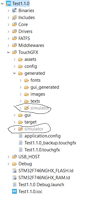

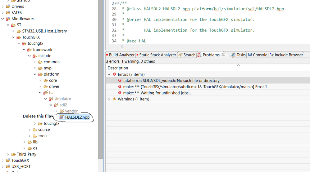

@scottSD Here are couple of things I did to make it work/compile fine.
(1) When you get the error at your 1st compile once you have set up touch gfx delete HALSDL2.hpp file.just excluding the folder from build is not good enough. see attached
(2) Once you have done step 1 compile again to be greeted by similar errors. Now exclude 2 simulator folders from build as shown in the attachment.
It should now build fine. Let me know hoe you get on
Regards
2019-10-21 6:22 AM
thanks zain.ulabidin1.5551676461061162E12
That took care of the simulator related errors. Now I'm getting the OSWrapper error.

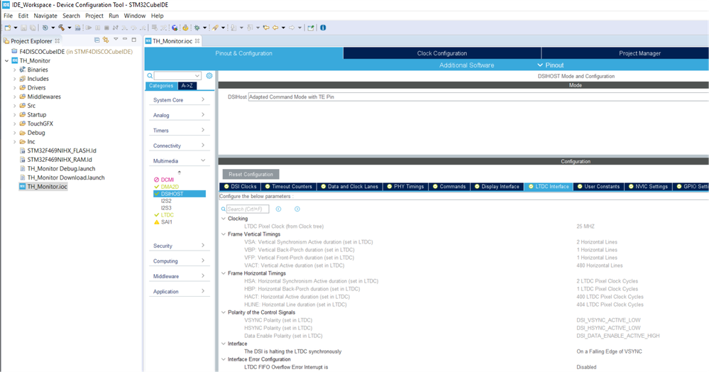

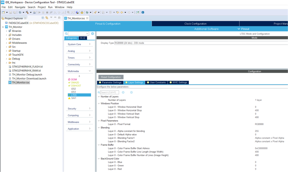

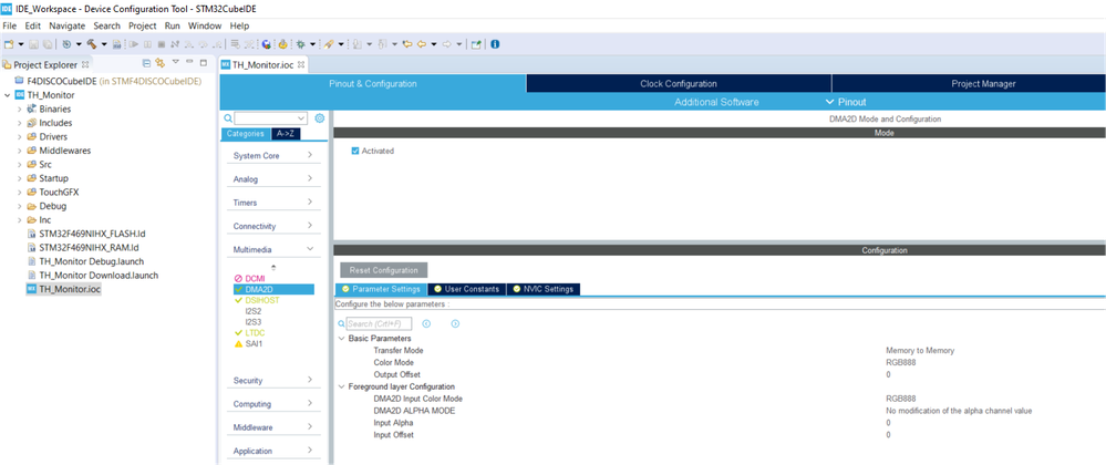

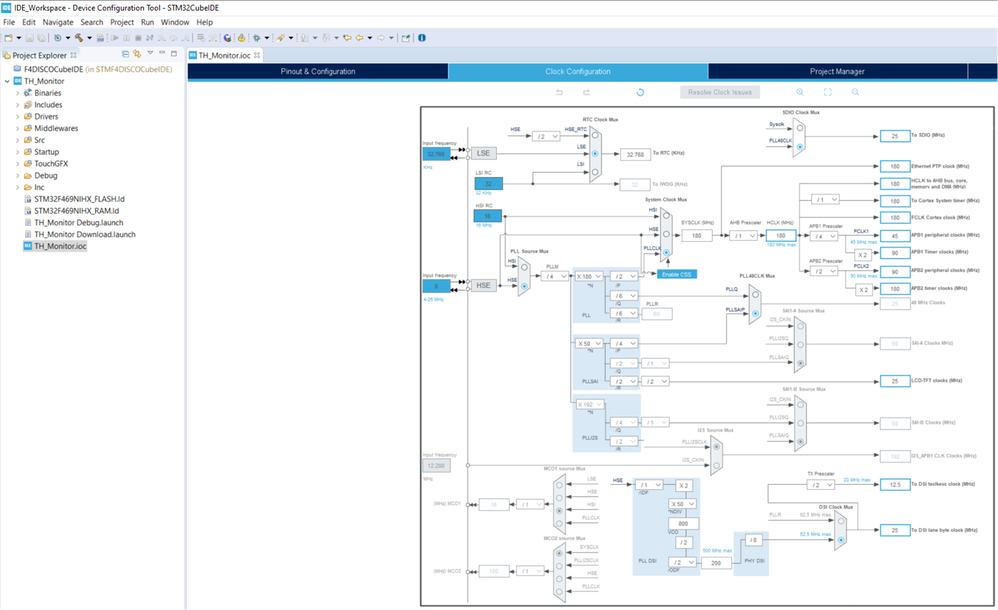

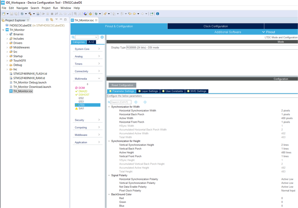

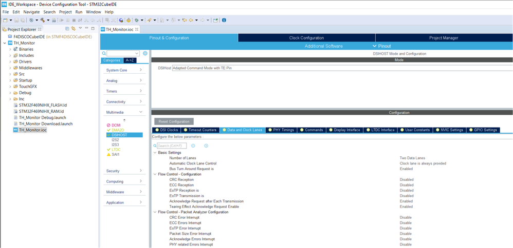

2019-11-12 12:35 PM
Hello Everyone,
I do the settings as following screenshots and then I generate code and resolve the issues on CubeIDE.
Now when download the program on STM32F469-Disco board the screen remains black (all 4 LEDs are on).
Would you please let me know what is missing?
Thanks,
