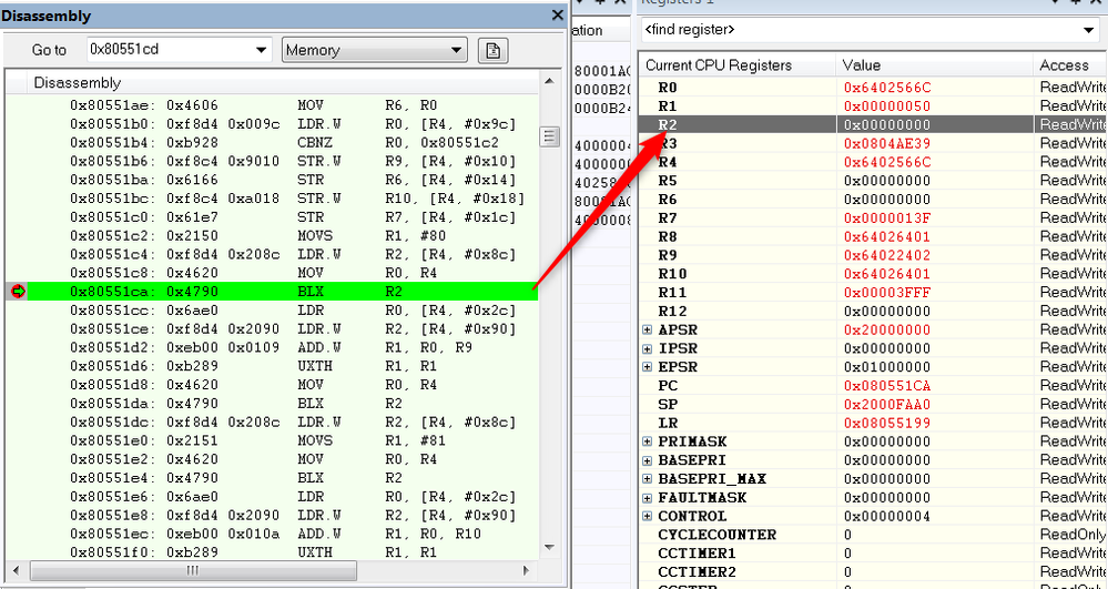

I want to make a font library to support multiple languages, it has to store all the necessary characters inside.
With the language with less characters like English, Italian, Deutsche .... we can store it to internal flash. But when including Simplified Chinese characters it did not enough space to put them all together, it has too much characters (more than 400 compare with 128 of ASCII)
STemWin supports us to convert the TTF font file to c source file which be used to font creating routine. (GUI_TTF_CreateFont())
1 - I did follow the example code from STemWin spec and it worked fine.
GUI_TTF_CS Cs0, Cs1;
GUI_TTF_DATA Data;
GUI_FONT Font0, Font1;
// Set parameters for accessing the font file
Data.pData = aTTF; // Address
Data.NumBytes = sizeof(aTTF); // Size
// Set creation parameters of first font
Cs0.pTTF = &Data; // Use address of GUI_TTF_DATA
Cs0.PixelHeight = 24; // Pixel height
Cs0.FaceIndex = 0; // Initialize to 0
// Set creation parameters of second font
Cs1.pTTF = &Data; // Use address of GUI_TTF_DATA
Cs1.PixelHeight = 48; // Pixel height
Cs1.FaceIndex = 0; // Initialize to 0
// Create 2 fonts
GUI_TTF_CreateFont(&Font0, &Cs0);
GUI_TTF_CreateFont(&Font1, &Cs1);
// Draw something using the fonts
GUI_SetFont(&Font0);
GUI_DispString("Hello world\n");
GUI_SetFont(&Font1);
GUI_DispString("Hello world");2 - Because I want to create more fonts and more languages then I mapped to the external RAM to get more space.
#pragma location=0x64000000
static __no_init U32 aMemory[GUI_NUMBYTES / 4];
//Map to the external RAM start address 0x64000000
void GUI_X_Config(void)
GUI_ALLOC_AssignMemory(aMemory, GUI_NUMBYTES);
}3 - When make a program with TTF font create and initialize GUI to external memory it run with hang hard fault error invalid instruction.

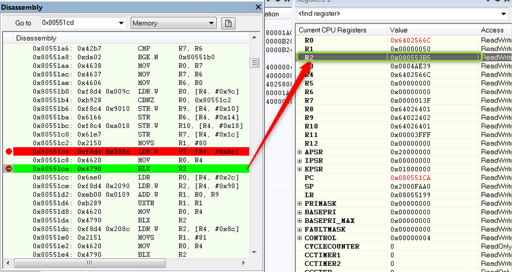

4 - But when put a break point above that hang point and run it again. The data read from external RAM had value available.
Please help me if any one has idea how to debug this problem ?
