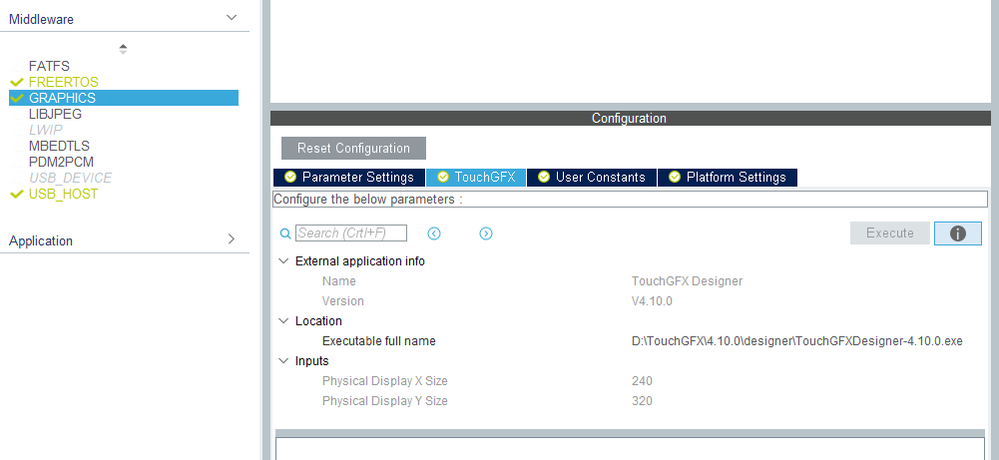

2019-01-17 2:48 AM
Hello Martin,
Thanks for your response.
I have an issue with the cube project you sent, I configured the right path of GFX Designer, but the "Execute" bottom is not activated?!!
Attached an image.
Could you please help ?
thx
2019-01-18 1:16 PM
Try to go to a different tab and then come back to this screen. Does that fix the Execute button?

2019-01-21 5:51 AM
No that does not fix the issue.
I tried with the package that I found in this thread
and the "execute" Bottom is working.

2019-01-22 12:08 AM
Hi @Community member
As of now, an .ioc file in the F429 is not included in the TouchGFX DEsigner example, but please note that we are working on implementing a F429 TouchGFX Designer example which includes an .ioc file.
Are you able to share your TouchGFX Log file? Thank you.
