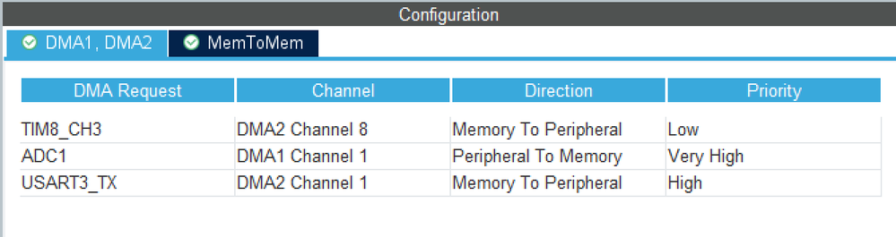

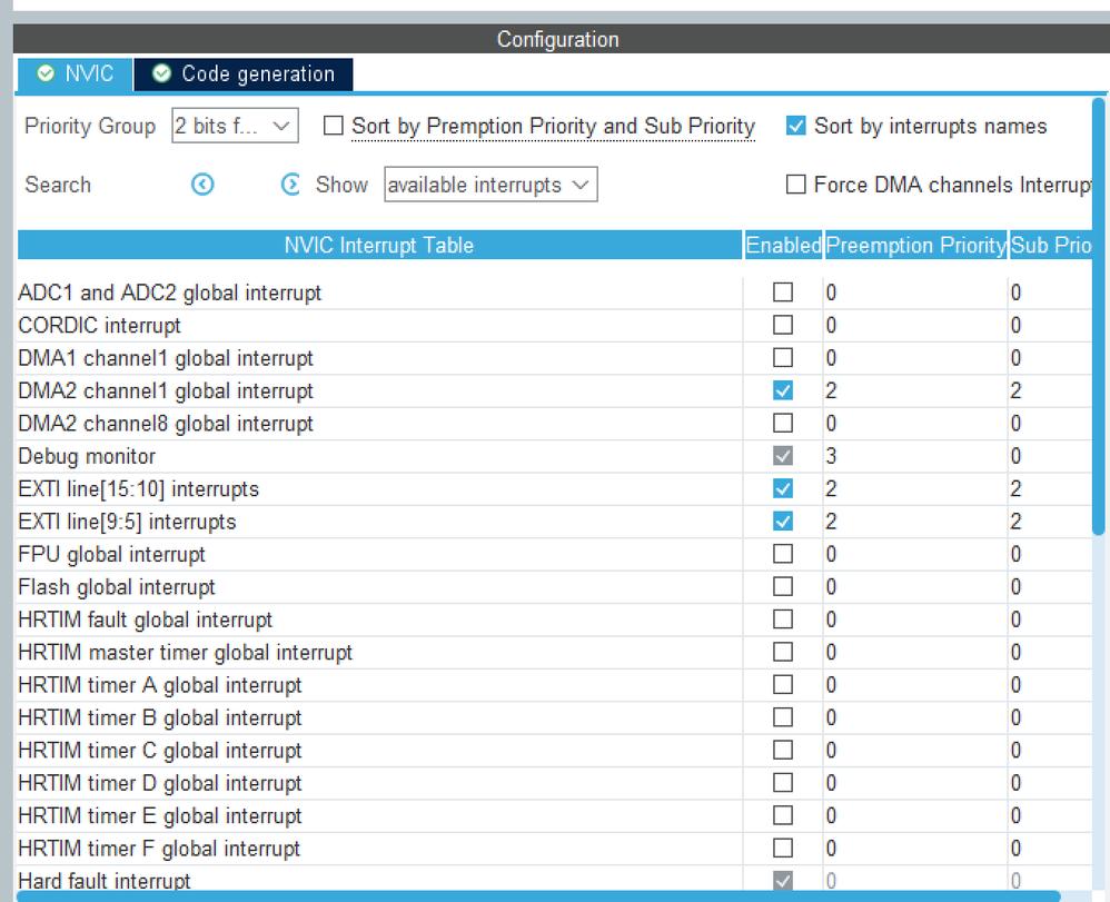

Here is my DMA's configuration
ADC and TIM8 are normal but USART3 transmission fail when DMA2 channel1's interrupt is disable. Here is the code which  generate by CubeMX.

  /* DMA2_Channel1_IRQn interrupt configuration */
  HAL_NVIC_SetPriority(DMA2_Channel1_IRQn, 2, 2);
  HAL_NVIC_EnableIRQ(DMA2_Channel1_IRQn);
