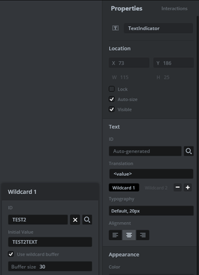

Hi friends, I have this problem:
static uint16_t txt[10];

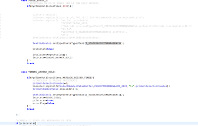

I tried, but not work, if you see, was in the first comment in the start. Everyting seems work in first attempt I call the machine, but from the second one not work...
this work very well..
I considering to open a touchgfx ticket... really strange issue.

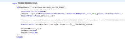

If you use setTypedText()- function in some machine state, you must return it also to the original single use id. Like this:
TextIndicator.setTypedText(touchgfx::TypedText(T___SINGLEUSE_IGD9));
Open your view-base.cpp and check singleuse ID there.
Maybe easier is to not use setTypedText, but do like this
Unicode::snprintf( TextIndicatorBuffer,TEXTINDICATOR_SIZE,"%s",TypedText(T_STATEPRODUCTMANAGERWC1).getText());
in the TIMING_ANSWER_HOLD, then the correct single-use ID stays.

Dear JTP1, I tried to change all lines in snprintf not using TextIndicator.setTypedText(blabla)... not work nothing at all! seems that if I use for this wildcard snprintf, after work once, it not will work over on this buffer.
if you look at the TIMING_ANSWER_HOLD, you can see the same for productSelectorCounter... and this work...
It work onli the first called routine in this sequence... after stop .

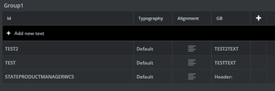

textarea settings:
Depending on your text lenghts, you might need to invalidate text area also before change content. (if new is shorter than old, and you are changing the ID from typed ID to wildcard ID).
Check all your instances of 'TextIndicator'. If you share your code as code, not picture, and more code, somebody might find your problem :thumbs_up:
