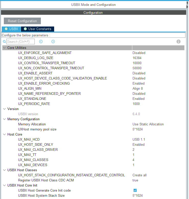

I'm looking to implement USB host functionality on an STM32C071 to connect with a single device that sends/receives serial data over USB so the only class I'm interested in is CDC, but I'm having trouble using USBX (I'm not using RTOS).
For now I haven't used and read/write functions, my goal was to start by checking the functionality of the callbacks inside "app_usbx_host.c" which are: device inserted/removed/connected/disconnected, enumeration fail and no USB device found. Each one sets a different flag to be handled inside the main loop.
I put a breakpoint inside the USB IRQ and when I connect the USB device it stops execution and confirms the breakpoint has been reached, however none of my flags are ever set,.
I suspect the reason might be because I haven't done anything to link the USB peripheral to the USBX stack, if the function responsible for that is ux_host_stack_hcd_register, I have no idea how to use it. The function prototype is:
UINT _ux_host_stack_hcd_register(UCHAR *hcd_name, UINT (*hcd_init_function)(struct UX_HCD_STRUCT *), ULONG hcd_param1, ULONG hcd_param2);I'm completely lost in the description for each of the arguments.

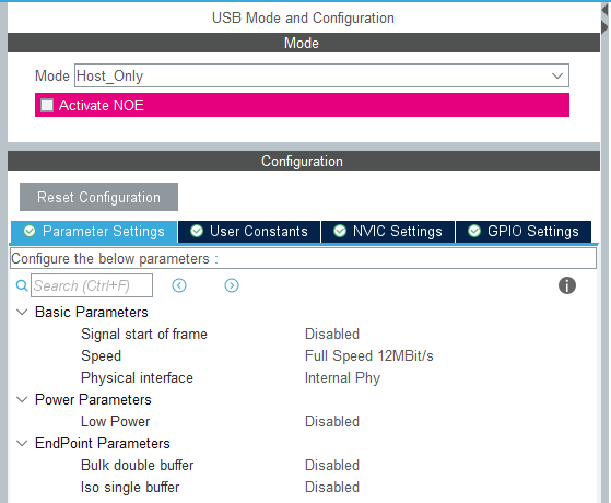

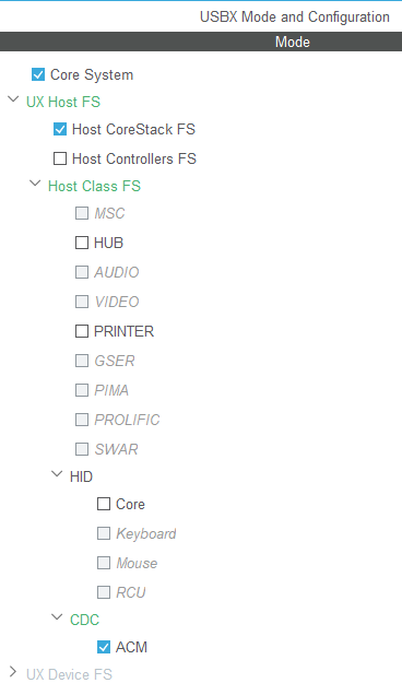

I don't remember making significant changes to any other file apart from creating the flags inside app_usbx_host.c.
The images below contain the CubeMX settings I used.
USB peripheral configuration
Class configuration
USBX configuration
I'd be extremely grateful if anyone could tell me what I missed.

Hi @vermas
You need to ensure initialization the USBX host stack, ensure it has enough memory, and poll its task function in the main loop. MX_USBX_Host_Init() must be called after MX_USB_HCD_Init() so the USBX host stack can properly register and link to the USB peripheral.
MX_USB_HCD_Init(); // Initialize the USB host controller
MX_USBX_Host_Init(); // Then initialize the USBX host stackIn your main loop, you also need to call ux_system_tasks_run(); and poll on your CDC task.
As a reference, start from this official example and then adapt/port it to your standalone application.
If still having issues, don't hesitate to share your project.
