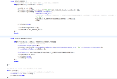

2023-07-17 2:50 AM - edited 2023-07-17 2:53 AM
this is a screenshot of the point:
As you can see, is a state machine that change simply the string value in screen after 2 temporized situations...
PS: TEXTINDICATORSIZE is 150 char... and usually I use no more then 50 char.
