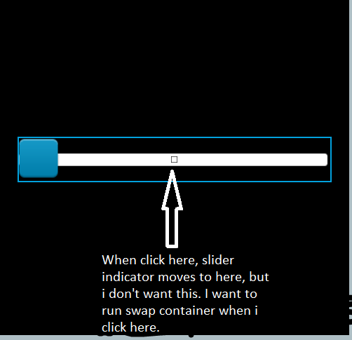

I want to use swap container and a slider on same page. But when i click on slider background, i can not use swipe container, i.e i can not swap to second page. I just want to update the slider when i drag the indicator, not with clicking the background. So how can i implement this? Any advise?

Hi @Martin KJELDSEN
Please see the attached screenshot.

Hi, @Martin KJELDSEN
Yes, i just want to press and drag the actual indicator and adjust its value. And yes, the slider is in a swipe container page. Do you have any advise for me ?

What happens if you actually try to drag the indicator? "Unfortunately", in your case, the standard slider-widget you're using accepts touch input for the entire area of its container (indicator + rest of the bar). You could modify the code (it's open to you) to only accept touch input for the indicator.
The remaining "challenge" is to handle when the touch goes to the swipe container and when it goes to the indicator. Because the standard behavior for the swipe container is to "steal" all touch input unless you handle it specifically. If you, as in your case, have other touch sensitive elements inside the swipe container.
How can i seperate the touchable property for indicator and rest of the bar ? I could not find any function about this.
I just want to swipe to second page from anywhere on the screen except the slider knob. This is only a design specification, because some users may want to slide screen from anywhere, so i want to control the slider with only its indicator. By the way , the setTouchable function can take one parameter of which true or false. How can we use this function with this aim?
