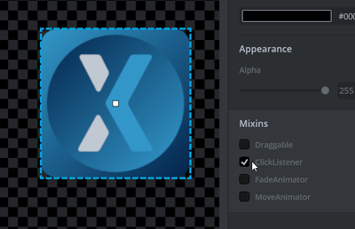

Hello @LXGMAX ,
Have a look at this video : https://www.youtube.com/watch?v=ldYSmHRLPEM&list=PLnMKNibPkDnF9x-s1e-v9Wtvv-fB88VWA&index=3
Basically, you can just check the "clickListener" at the bottom of the properties of the image:
Regards,

2025-07-10 8:18 AM
Hello @LXGMAX ,
Regards,
