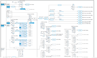

@LouisB  I tested the GUI in a simulator project, thanks for this hint. So the CWR requires 52552 bytes. Therefore I set the Canvas Buffer Size in our project to 54000 bytes. But the second page of our swipe container is still a little bit laggy. Is there another way to improve this behaviour?
We use STM32U5A9NJH6Q (running @160Mhz). Are there some settings (hardware accelerators e.g.) which can be set?
Best regards,
