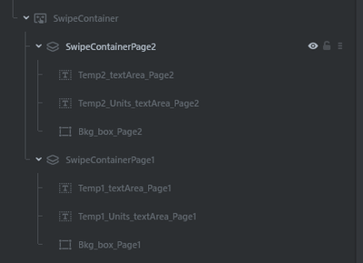

I've implemented, using the Designer, a Swipe container composed by 2 pages which are respectively 2 containers (SwipeContainerPage1, SwipeContainerPage2).
Each page includes some text and box which are updated on page swipe change and everything works fine.
Now I want to command an Action (a page change) when the user presses for a couple of seconds (let's say 2 seconds) SwipeContainerPage1 or SwipeContainerPage2 while maintaing the swiping property of this macro object.
Is this possible? I've taken as a reference the "ClickListener_Implementation_longPress" as a reference but with no success...
(Edited) I tried doing this and it works for the first page (calls goTo_GUITemperatureSet_Action()) but it blocks the swipe capability and I cannot go to the SwipeContainerPage2:

}Probably I've should've asked this question before:
is it possible to have both the swipe feature (setup from the designer, it contain two pages: SwipeContainerPage1 and SwipeContainerPage2) and setup afterwards the clickListener (in the user code) for SwipeContainerPage1 and SwipeContainerPage2 to trigger a long pressure on those containers? Or should I setup the Mixin ClickListener to the objects inside the container to make it work (for example Temp2_textArea_Page2 and Temp1_textArea_Page1) ?
