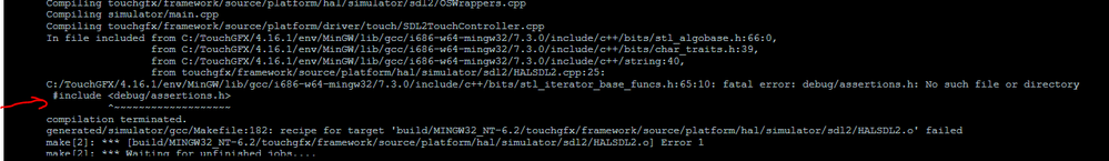

When starting Simulator it always fails even if I start completly fresh new project: I get the same result:
In file included from C:/TouchGFX/4.16.1/env/MinGW/lib/gcc/i686-w64-mingw32/7.3.0/include/c++/bits/stl_algobase.h:66:0,
from C:/TouchGFX/4.16.1/env/MinGW/lib/gcc/i686-w64-mingw32/7.3.0/include/c++/bits/char_traits.h:39,
from C:/TouchGFX/4.16.1/env/MinGW/lib/gcc/i686-w64-mingw32/7.3.0/include/c++/string:40,
from touchgfx/framework/source/platform/hal/simulator/sdl2/HALSDL2.cpp:25:
C:/TouchGFX/4.16.1/env/MinGW/lib/gcc/i686-w64-mingw32/7.3.0/include/c++/bits/stl_iterator_base_funcs.h:65:10: fatal error: debug/assertions.h: No such file or directory
#include <debug/assertions.h>

Did you always face this or is this happened out of nowhere today ? Do you face it with all TouchGFX version or just TouchGFX 4.16.1 ? What OS are you working with (Windows x, mac, linux?) ?
Could you share your logfile ? It can be found under %appdata/Roaming/TouchGFX-4.16.1
/Romain

I am using Windows 10. I recently installed TouchGFX 4.18 but then i uninstalled it. I am trying this on the TouchGFX 4.16.1. I am not sure if simualation was possible before because I just started at a new company and am using a computer form an earlyer person. I am sending the log file in the attachment.

Hum I have never seen this error before, I have sent a message to the team in charge of the simulator but in the meantime I would suggest uninstalling and installing again TouchGFX just in case something went wrong.
