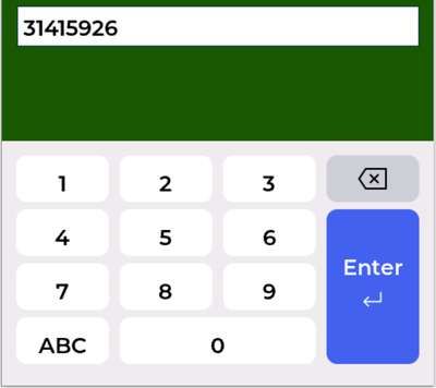

Hello @NicoEFI,
I think you can consider your button with the text area corresponding to it as a custom container which contains a variable for saving the typed value. In this way, when the circular button is pressed, you can call a function that copies the keyboard buffer (Keypad::getText()) to your variable, and then you can display that value in the corresponding text area.
I hope this helps you!

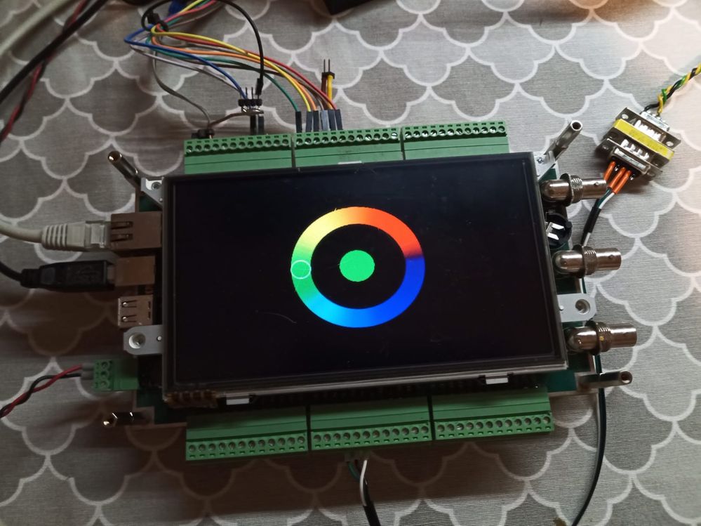

I thought about something similar, yet using a predefined palette. The idea was loading it from a CLUT table (out of L8_xxx bitmap) or define it directly as an array of RGB colors.
LTone board running ColorPicker widget

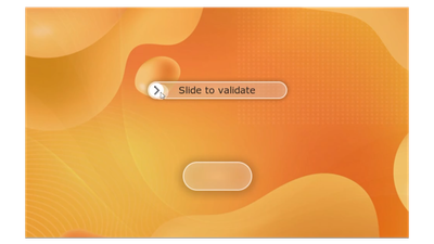

Please find attached a new custom widget (tpkg file and example of usage).
It is a confirmation/validation slider, the type you have on payment services.
I hope you like it! :smiling_face_with_smiling_eyes:
To see how I created the widget and how to use it watch this video !

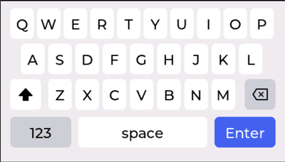

Could you please let me know what steps should I follow or how shall I use it touchgfx application?
I mean I need to get the typed names (from keyboard) into username and password textarea. I have imported the .tpkg file, able to add the widget into screen and now what next to do to get the typed data into Username and Password for authentication.

This thread is mostly to share custom widgets, not to ask questions otherwise it will get spammed very fast. :)
If you want to have an answer, I suggest you to create a new thread with details of what you want to do and with a reference to the custom container you want to use.
To give you a quick answer, the keyboard have a function called getText in the Keyboard.cpp that returns the buffer storing the data, so it seems you should call that function and write the returned value into your desired textArea.
If this answer is not enough, please create a new thread.
